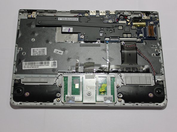

    • Lay the Chromebook down so that the bottom cover is facing up.
    • Remove the rubber feet on the four corners of the Chromebook in order to get to the screws underneath. They are stuck on with an adhesive.
  2. Samsung Chromebook Series 3 Speaker Replacement: crwdns2935265:02crwdnd2935265:01crwdnd2935265:03crwdne2935265:0 Samsung Chromebook Series 3 Speaker Replacement: crwdns2935265:02crwdnd2935265:02crwdnd2935265:03crwdne2935265:0 Samsung Chromebook Series 3 Speaker Replacement: crwdns2935265:02crwdnd2935265:03crwdnd2935265:03crwdne2935265:0
    • Remove the nine 4.7 mm screws on the bottom cover using a Phillips #00 screwdriver.
  3. Samsung Chromebook Series 3 Speaker Replacement: crwdns2935265:03crwdnd2935265:01crwdnd2935265:03crwdne2935265:0 Samsung Chromebook Series 3 Speaker Replacement: crwdns2935265:03crwdnd2935265:02crwdnd2935265:03crwdne2935265:0 Samsung Chromebook Series 3 Speaker Replacement: crwdns2935265:03crwdnd2935265:03crwdnd2935265:03crwdne2935265:0
    • Pry up the plastic strip on the back of the Chromebook using a plastic opening tool.
    • It is not necessary to remove it completely. It just needs to be separated from the bottom cover.
  4. Samsung Chromebook Series 3 Speaker Replacement: crwdns2935265:04crwdnd2935265:01crwdnd2935265:03crwdne2935265:0 Samsung Chromebook Series 3 Speaker Replacement: crwdns2935265:04crwdnd2935265:02crwdnd2935265:03crwdne2935265:0 Samsung Chromebook Series 3 Speaker Replacement: crwdns2935265:04crwdnd2935265:03crwdnd2935265:03crwdne2935265:0
    • Pry off the bottom cover using a plastic opening tool.
  5. Samsung Chromebook Series 3 Speaker Replacement, Battery: crwdns2935265:05crwdnd2935265:01crwdnd2935265:03crwdne2935265:0 Samsung Chromebook Series 3 Speaker Replacement, Battery: crwdns2935265:05crwdnd2935265:02crwdnd2935265:03crwdne2935265:0 Samsung Chromebook Series 3 Speaker Replacement, Battery: crwdns2935265:05crwdnd2935265:03crwdnd2935265:03crwdne2935265:0
    • Remove six 3.5 mm screws holding the battery using a Phillips #00 screwdriver.
    • Pull out the battery partway in order to easily get to the battery connector.
  6. Samsung Chromebook Series 3 Speaker Replacement: crwdns2935265:06crwdnd2935265:01crwdnd2935265:03crwdne2935265:0 Samsung Chromebook Series 3 Speaker Replacement: crwdns2935265:06crwdnd2935265:02crwdnd2935265:03crwdne2935265:0 Samsung Chromebook Series 3 Speaker Replacement: crwdns2935265:06crwdnd2935265:03crwdnd2935265:03crwdne2935265:0
    • Disconnect the battery connector by pulling straight up at its base.
    • When reassembling, simply position the connector above it's original place, and push down.
  7. Samsung Chromebook Series 3 Speaker Replacement: crwdns2935265:07crwdnd2935265:01crwdnd2935265:02crwdne2935265:0 Samsung Chromebook Series 3 Speaker Replacement: crwdns2935265:07crwdnd2935265:02crwdnd2935265:02crwdne2935265:0
    • You can now remove the battery.

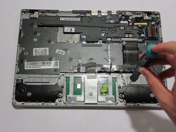

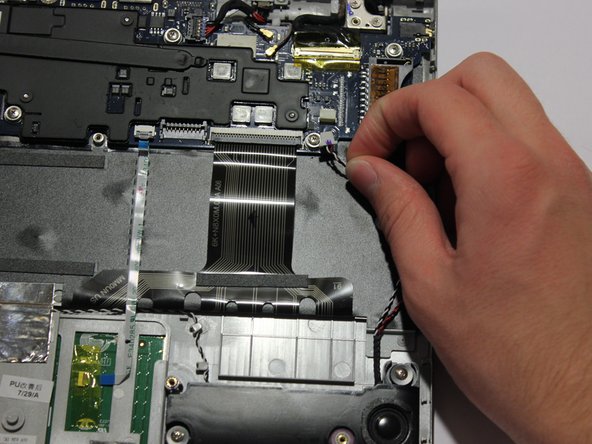

  8. Samsung Chromebook Series 3 Speaker Replacement, Speaker: crwdns2935265:08crwdnd2935265:01crwdnd2935265:03crwdne2935265:0 Samsung Chromebook Series 3 Speaker Replacement, Speaker: crwdns2935265:08crwdnd2935265:02crwdnd2935265:03crwdne2935265:0 Samsung Chromebook Series 3 Speaker Replacement, Speaker: crwdns2935265:08crwdnd2935265:03crwdnd2935265:03crwdne2935265:0
    • Disconnect the cable connecting the speakers to the motherboard by pulling on it away from the motherboard.

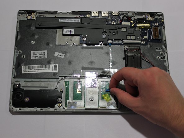

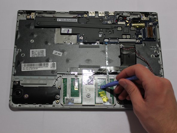

  9. Samsung Chromebook Series 3 Speaker Replacement: crwdns2935265:09crwdnd2935265:01crwdnd2935265:03crwdne2935265:0 Samsung Chromebook Series 3 Speaker Replacement: crwdns2935265:09crwdnd2935265:02crwdnd2935265:03crwdne2935265:0 Samsung Chromebook Series 3 Speaker Replacement: crwdns2935265:09crwdnd2935265:03crwdnd2935265:03crwdne2935265:0
    • Lift up the piece of tape covering the trackpad ribbon cable.
    • Lift up the lock on the trackpad ribbon cable using a plastic opening tool.
    • Disconnect the trackpad ribbon cable by pulling it out.

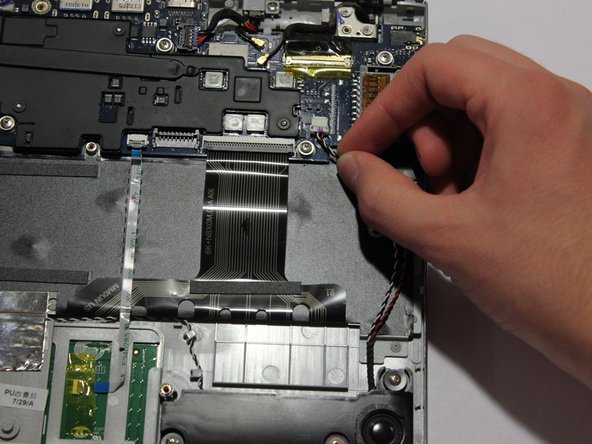

  10. Samsung Chromebook Series 3 Speaker Replacement: crwdns2935265:010crwdnd2935265:01crwdnd2935265:02crwdne2935265:0 Samsung Chromebook Series 3 Speaker Replacement: crwdns2935265:010crwdnd2935265:02crwdnd2935265:02crwdne2935265:0
    • Lift up the trackpad ribbon cable so that it is not covering the speaker wire.
    • Lift up the two pieces of metallic tape so that they no longer cover the speaker wire.
    • When reassembling the device, make sure to lay down the metallic tape in the same place it was prior to disassembly. The tape serves as a connector for certain electrical circuits that should not be disconnected.

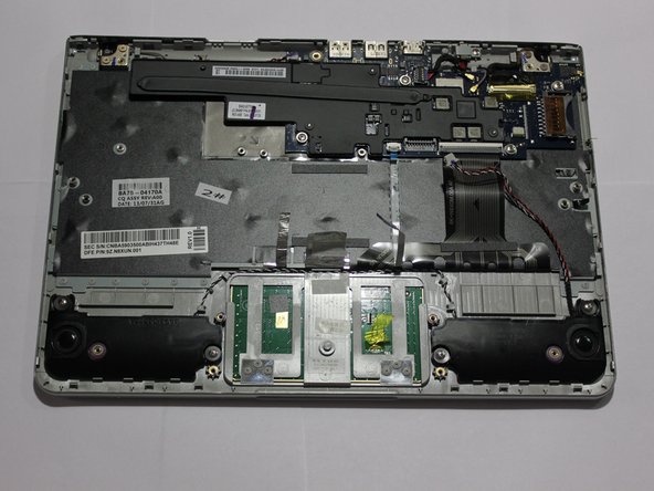

  11. Samsung Chromebook Series 3 Speaker Replacement: crwdns2935265:011crwdnd2935265:01crwdnd2935265:03crwdne2935265:0 Samsung Chromebook Series 3 Speaker Replacement: crwdns2935265:011crwdnd2935265:02crwdnd2935265:03crwdne2935265:0 Samsung Chromebook Series 3 Speaker Replacement: crwdns2935265:011crwdnd2935265:03crwdnd2935265:03crwdne2935265:0
    • Unscrew the four 3.7 mm screws holding down the speakers using a Phillips #00 screwdriver.
  12. Samsung Chromebook Series 3 Speaker Replacement: crwdns2935265:012crwdnd2935265:01crwdnd2935265:02crwdne2935265:0 Samsung Chromebook Series 3 Speaker Replacement: crwdns2935265:012crwdnd2935265:02crwdnd2935265:02crwdne2935265:0
    • Pull the speakers up to remove them.
