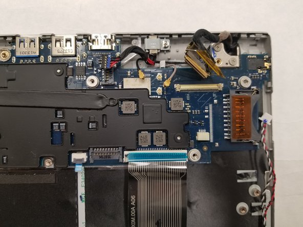

  8. Samsung Chromebook Series 3 Motherboard Replacement, Motherboard: crwdns2935265:08crwdnd2935265:01crwdnd2935265:03crwdne2935265:0 Samsung Chromebook Series 3 Motherboard Replacement, Motherboard: crwdns2935265:08crwdnd2935265:02crwdnd2935265:03crwdne2935265:0 Samsung Chromebook Series 3 Motherboard Replacement, Motherboard: crwdns2935265:08crwdnd2935265:03crwdnd2935265:03crwdne2935265:0
    • Unscrew the four 3.1 mm screws holding the motherboard with a Phillips #00 screwdriver.
  9. Samsung Chromebook Series 3 Motherboard Replacement: crwdns2935265:09crwdnd2935265:01crwdnd2935265:03crwdne2935265:0 Samsung Chromebook Series 3 Motherboard Replacement: crwdns2935265:09crwdnd2935265:02crwdnd2935265:03crwdne2935265:0 Samsung Chromebook Series 3 Motherboard Replacement: crwdns2935265:09crwdnd2935265:03crwdnd2935265:03crwdne2935265:0
    • The audio cable can be removed by simply pulling gently.
    • Use the iFixit opening tool to pop out the 2 antennae lines from the motherboard.
    • When reinstalling these Wifi Antenna connections, align the antenna on top of the fitting and gently use the Plastic Spudger to apply pressure and seat the connection. Do not use your fingers to press down on the connector, or you risk permanently damaging the connector by bending it.

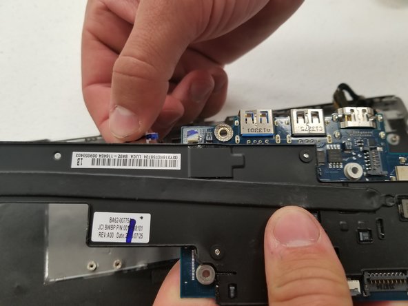

  10. Samsung Chromebook Series 3 Motherboard Replacement: crwdns2935265:010crwdnd2935265:01crwdnd2935265:03crwdne2935265:0 Samsung Chromebook Series 3 Motherboard Replacement: crwdns2935265:010crwdnd2935265:02crwdnd2935265:03crwdne2935265:0 Samsung Chromebook Series 3 Motherboard Replacement: crwdns2935265:010crwdnd2935265:03crwdnd2935265:03crwdne2935265:0
    • Now, disconnect the keyboard and trackpad ribbon cables.
    • This requires lifting the lever securing the cables to free them, and then gently pulling them out.

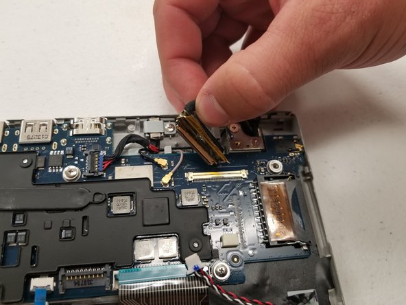

  11. Samsung Chromebook Series 3 Motherboard Replacement: crwdns2935265:011crwdnd2935265:01crwdnd2935265:03crwdne2935265:0 Samsung Chromebook Series 3 Motherboard Replacement: crwdns2935265:011crwdnd2935265:02crwdnd2935265:03crwdne2935265:0 Samsung Chromebook Series 3 Motherboard Replacement: crwdns2935265:011crwdnd2935265:03crwdnd2935265:03crwdne2935265:0
    • The screen cable is secure in place by a lever. Lift the lever to release it, then gently pull it out.

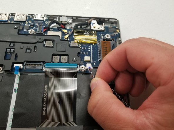

  12. Samsung Chromebook Series 3 Motherboard Replacement: crwdns2935265:012crwdnd2935265:01crwdnd2935265:01crwdne2935265:0
    • This cable comes out by just pulling gently.
