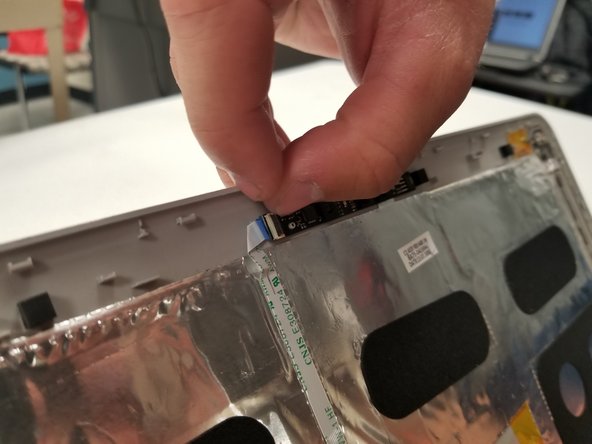

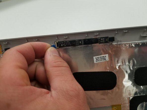

  5. Samsung Chromebook Series 3 Front Camera Replacement, Front Camera: crwdns2935265:05crwdnd2935265:01crwdnd2935265:03crwdne2935265:0 Samsung Chromebook Series 3 Front Camera Replacement, Front Camera: crwdns2935265:05crwdnd2935265:02crwdnd2935265:03crwdne2935265:0 Samsung Chromebook Series 3 Front Camera Replacement, Front Camera: crwdns2935265:05crwdnd2935265:03crwdnd2935265:03crwdne2935265:0
    • Disconnect the ribbon cable connected to the front camera assembly.
    • You will need to flip up the little black lever to release the cable.
  6. Samsung Chromebook Series 3 Front Camera Replacement: crwdns2935265:06crwdnd2935265:01crwdnd2935265:02crwdne2935265:0 Samsung Chromebook Series 3 Front Camera Replacement: crwdns2935265:06crwdnd2935265:02crwdnd2935265:02crwdne2935265:0
    • Use an iFixit opening tool to pry the front camera assembly from the adhesive holding it in place.

Thanks for posting this! I looked all over youtube and couldn’t find anything so I am relieved to find this tutorial! I haven’t performed the repair yet, but I was wondering if removing the screen is necessary. From what I see, I can access the camera by just removing the bezel. Thanks for your feedback in advance!
