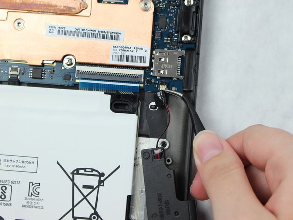

    • Remove the one 40 mm silver screw using the JIS J000 screw bit.
  4. Samsung Chromebook Pro Speaker Replacement: crwdns2935265:04crwdnd2935265:01crwdnd2935265:03crwdne2935265:0 Samsung Chromebook Pro Speaker Replacement: crwdns2935265:04crwdnd2935265:02crwdnd2935265:03crwdne2935265:0 Samsung Chromebook Pro Speaker Replacement: crwdns2935265:04crwdnd2935265:03crwdnd2935265:03crwdne2935265:0

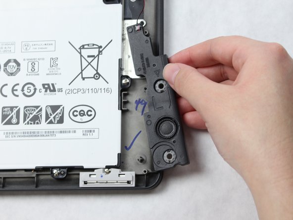

    • Using the precision tweezers lift the wire to disconnect.

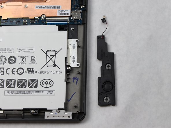

    • Remove the speaker.
