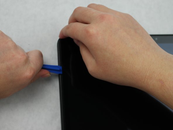

    2. Samsung Chromebook Pro Screen Replacement: crwdns2935265:02crwdnd2935265:01crwdnd2935265:03crwdne2935265:0 Samsung Chromebook Pro Screen Replacement: crwdns2935265:02crwdnd2935265:02crwdnd2935265:03crwdne2935265:0 Samsung Chromebook Pro Screen Replacement: crwdns2935265:02crwdnd2935265:03crwdnd2935265:03crwdne2935265:0
      • Insert the plastic opening tool between the hinge and plastic lining and pry upwards.
      • Continue to use the plastic opening tool along to the plastic lining to completely remove.

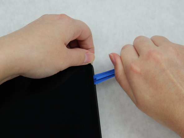

    4. Samsung Chromebook Pro Screen Replacement: crwdns2935265:04crwdnd2935265:01crwdnd2935265:03crwdne2935265:0 Samsung Chromebook Pro Screen Replacement: crwdns2935265:04crwdnd2935265:02crwdnd2935265:03crwdne2935265:0 Samsung Chromebook Pro Screen Replacement: crwdns2935265:04crwdnd2935265:03crwdnd2935265:03crwdne2935265:0
      • Begin lifting the screen by prying upward using the plastic opening tool.
      • Work around the screen by lifting upward with the plastic opening tool until the screen is completely off.

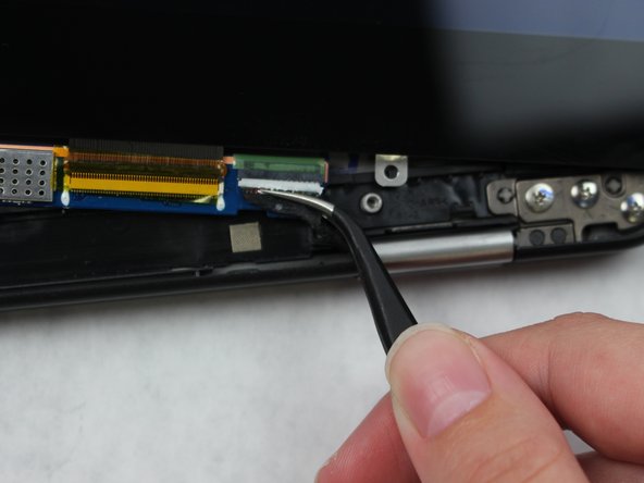

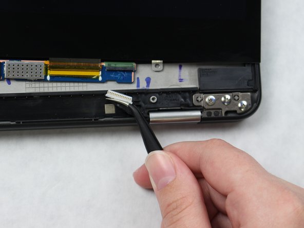

    5. Samsung Chromebook Pro Screen Replacement: crwdns2935265:05crwdnd2935265:01crwdnd2935265:02crwdne2935265:0 Samsung Chromebook Pro Screen Replacement: crwdns2935265:05crwdnd2935265:02crwdnd2935265:02crwdne2935265:0
      • Locate the black and gold wire on the left side of the screen, and pry the bar upward using the precision tweezers.
      • Disconnect the wire using the precision tweezers.

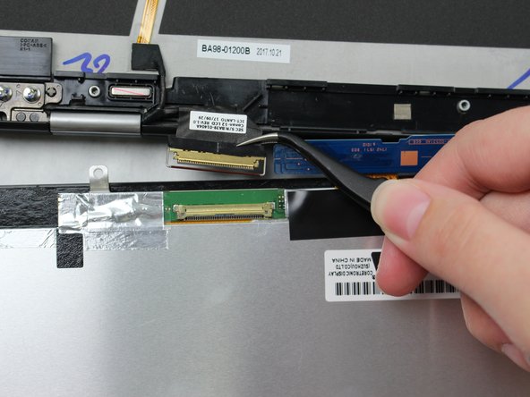

    6. Samsung Chromebook Pro Screen Replacement: crwdns2935265:06crwdnd2935265:01crwdnd2935265:03crwdne2935265:0 Samsung Chromebook Pro Screen Replacement: crwdns2935265:06crwdnd2935265:02crwdnd2935265:03crwdne2935265:0 Samsung Chromebook Pro Screen Replacement: crwdns2935265:06crwdnd2935265:03crwdnd2935265:03crwdne2935265:0
      • Disconnect the wire connected to the right side of the screen using the precision tweezers.

Hmm, followed this in an effort to repair a broken hinge. Fortunately, the screen didn’t break when the hinge came through the front of the monitor. Less fortunately, the prying described in step 4 totally blacked out the lower right corner of my screen. Damaged area is about the size of my thumbnail. Touchscreen still works and the machine is still usable, but so much for knowing what time it is…
