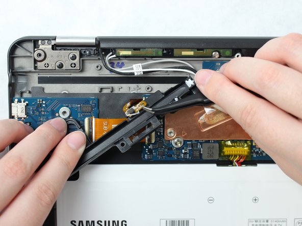

      • Locate the two white wires and one black wire. With the flat precision tweezers, untangle the white wires from the CONAN >PC+ABS< # 1-1.
      • Completely disconnect the black wire.

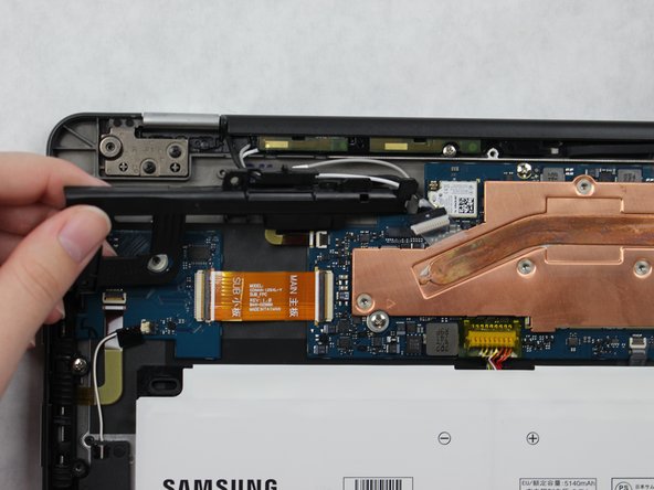

      • Remove the three 30 mm screws using the JIS J000 screw bit from the black CONAN >PC+ABS< # 1-1 plate.
      • Once all the screws are removed from the CONAN >PC+ABS< # 1-1 plate, remove the wire attached to underside and lift the plate to remove.

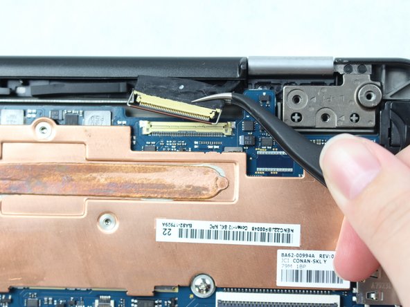

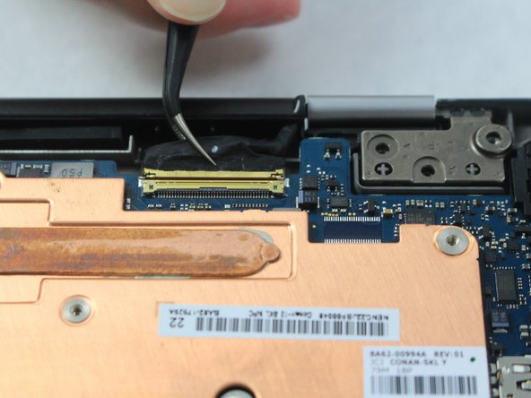

      • On the right top corner, locate the black and gold wire.
      • Lift the bar that is locking the wire in using the precision tweezers.
      • Disconnect the wire by grasping the black portion with the precision tweezers, and then pulling away from the Chromebook Pro.

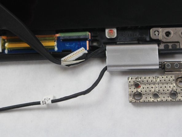

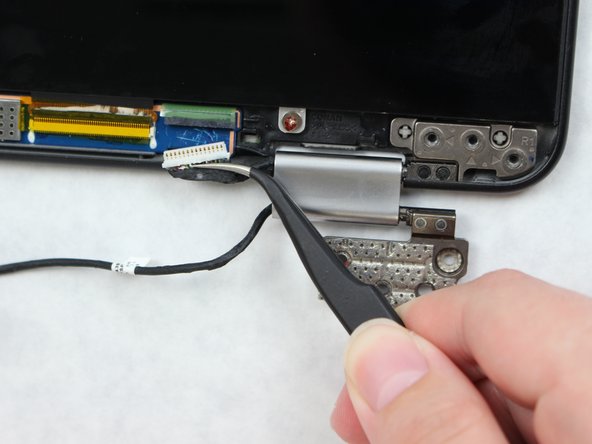

      • Disconnect the black wire on the R1 plate connected to the screen using the precision tweezers.
    11. Samsung Chromebook Pro Hinge Replacement: crwdns2935265:011crwdnd2935265:01crwdnd2935265:03crwdne2935265:0 Samsung Chromebook Pro Hinge Replacement: crwdns2935265:011crwdnd2935265:02crwdnd2935265:03crwdne2935265:0 Samsung Chromebook Pro Hinge Replacement: crwdns2935265:011crwdnd2935265:03crwdnd2935265:03crwdne2935265:0
      • Lift the hinge to remove from the Samsung Chromebook Pro.

How did you remove/unloop the cables in the hinges? do they just come right off?
Darby - crwdns2934203:0crwdne2934203:0 crwdns2950251:0crwdne2950251:0
The cables are just pushed into the side of the hinge. One side had a stopper holding the cable in place that I had to pull out, but the other had nothing holding the cable (that was the broken hinge on my chromebook, so maybe it had a stopper that had fallen out at one point). Once the stopper was removed from the one hinge, I could pull the cables out, and push them into new hinges.
