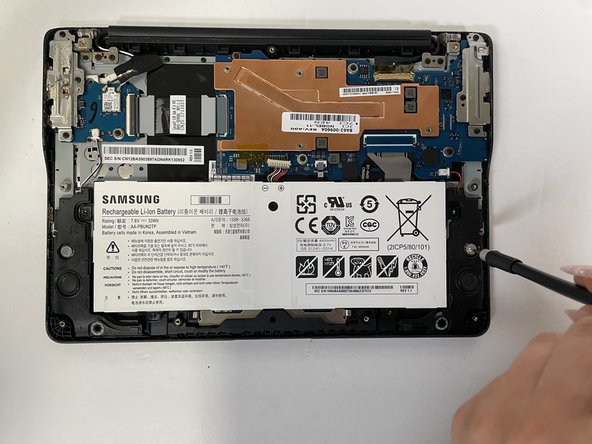

    • Place the Chromebook face down so the bottom case is uncovered.
    • Use the Phillips #00 screwdriver to remove all nine 4.6mm screws from the back case.

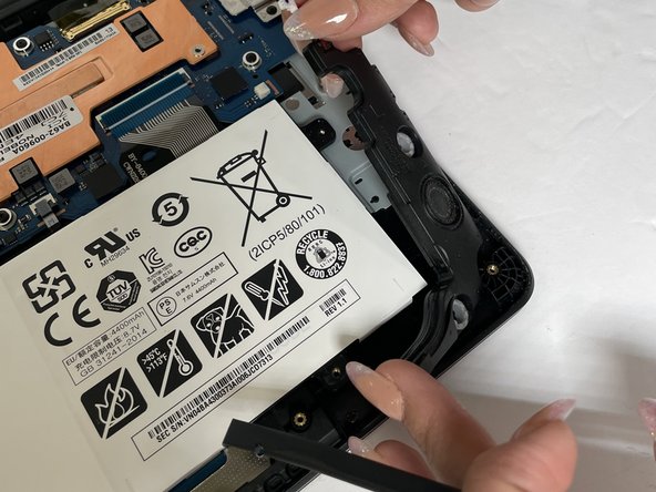

  2. Samsung Chromebook 3 XE500C13-K05US Speaker Replacement: crwdns2935265:02crwdnd2935265:01crwdnd2935265:01crwdne2935265:0
    • Use a nylon spudger or plastic opening tool to pry the case up from the vent on the hinge side of the Chromebook.
    • You will hear a popping sound as the connectors disengage inside the case.
  3. Samsung Chromebook 3 XE500C13-K05US Speaker Replacement: crwdns2935265:03crwdnd2935265:01crwdnd2935265:01crwdne2935265:0
    • Raise the case up and off the device.

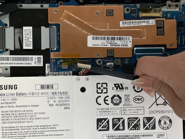

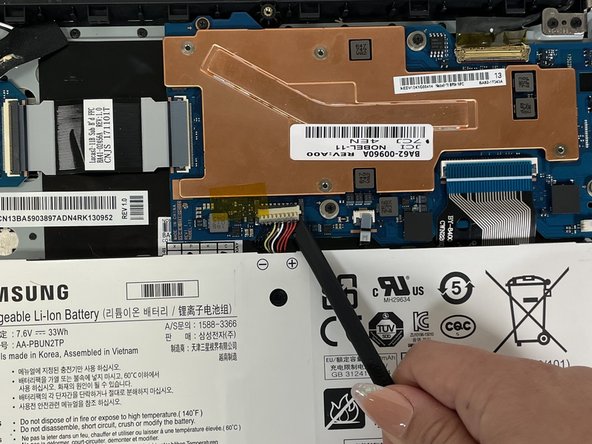

  4. Samsung Chromebook 3 XE500C13-K05US Speaker Replacement: crwdns2935265:04crwdnd2935265:01crwdnd2935265:03crwdne2935265:0 Samsung Chromebook 3 XE500C13-K05US Speaker Replacement: crwdns2935265:04crwdnd2935265:02crwdnd2935265:03crwdne2935265:0 Samsung Chromebook 3 XE500C13-K05US Speaker Replacement: crwdns2935265:04crwdnd2935265:03crwdnd2935265:03crwdne2935265:0
    • Disconnect the battery from the motherboard by prying upwards on the cable connector with a spudger.

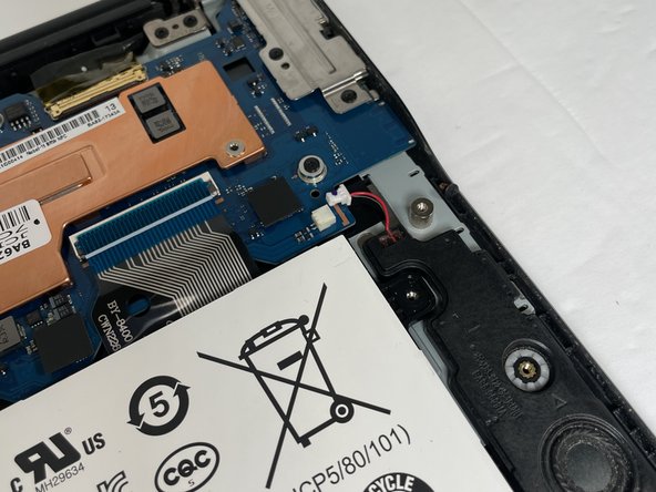

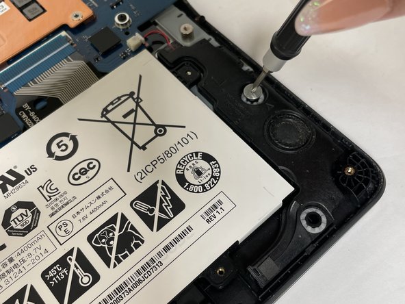

    • Remove one 4.9mm silver screw from each speaker.
  6. Samsung Chromebook 3 XE500C13-K05US Speaker Replacement: crwdns2935265:06crwdnd2935265:01crwdnd2935265:03crwdne2935265:0 Samsung Chromebook 3 XE500C13-K05US Speaker Replacement: crwdns2935265:06crwdnd2935265:02crwdnd2935265:03crwdne2935265:0 Samsung Chromebook 3 XE500C13-K05US Speaker Replacement: crwdns2935265:06crwdnd2935265:03crwdnd2935265:03crwdne2935265:0
    • Use a spudger to gently push the cable connector sideways from the motherboard and the left speaker to disconnect the cable.
    • Remove the speaker.

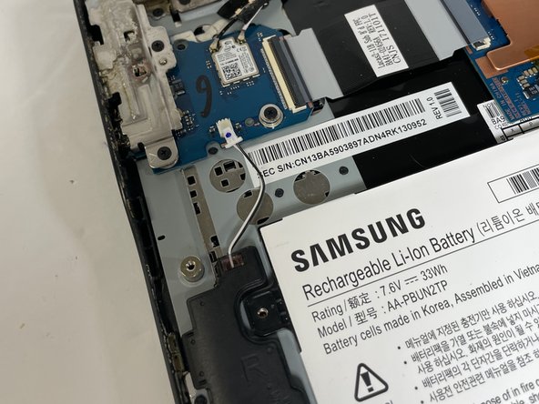

  7. Samsung Chromebook 3 XE500C13-K05US Speaker Replacement: crwdns2935265:07crwdnd2935265:01crwdnd2935265:02crwdne2935265:0 Samsung Chromebook 3 XE500C13-K05US Speaker Replacement: crwdns2935265:07crwdnd2935265:02crwdnd2935265:02crwdne2935265:0
    • Use a spudger to gently push the cable connector sideways from the motherboard and the right speaker to disconnect the cable.
