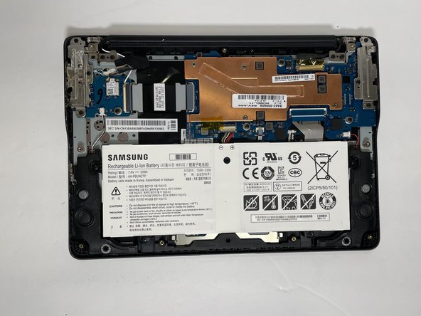

  4. Samsung Chromebook 3 XE500C13-K05US LCD Replacement: crwdns2935265:04crwdnd2935265:01crwdnd2935265:02crwdne2935265:0 Samsung Chromebook 3 XE500C13-K05US LCD Replacement: crwdns2935265:04crwdnd2935265:02crwdnd2935265:02crwdne2935265:0

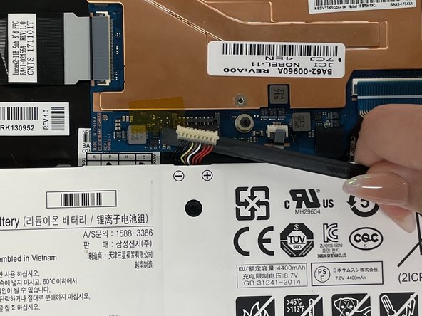

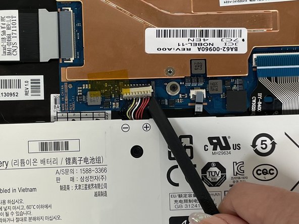

    • Unscrew and remove the four screws that secure the battery.
  5. Samsung Chromebook 3 XE500C13-K05US LCD Replacement: crwdns2935265:05crwdnd2935265:01crwdnd2935265:03crwdne2935265:0 Samsung Chromebook 3 XE500C13-K05US LCD Replacement: crwdns2935265:05crwdnd2935265:02crwdnd2935265:03crwdne2935265:0 Samsung Chromebook 3 XE500C13-K05US LCD Replacement: crwdns2935265:05crwdnd2935265:03crwdnd2935265:03crwdne2935265:0
    • Use a spudger to pry underneath the battery cable connector, and gently lift the connector up.
  6. Samsung Chromebook 3 XE500C13-K05US LCD Replacement: crwdns2935265:06crwdnd2935265:01crwdnd2935265:01crwdne2935265:0
    • Lift the battery out of the case to remove it from the laptop.

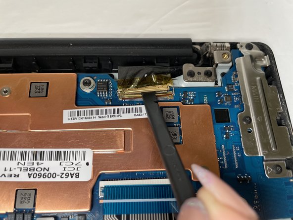

  7. Samsung Chromebook 3 XE500C13-K05US LCD Replacement, LCD: crwdns2935265:07crwdnd2935265:01crwdnd2935265:02crwdne2935265:0 Samsung Chromebook 3 XE500C13-K05US LCD Replacement, LCD: crwdns2935265:07crwdnd2935265:02crwdnd2935265:02crwdne2935265:0
    • Use a spudger to lift the hinge that locks the gold colored display cable in place.
    • Pop the cable out and remove the hinge from the motherboard.

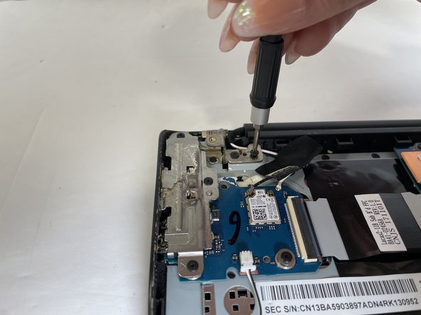

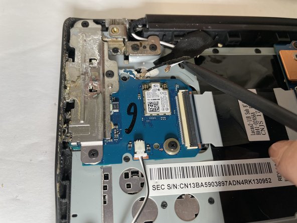

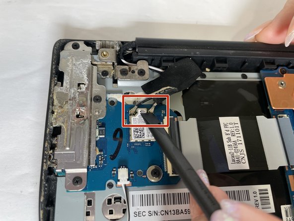

  8. Samsung Chromebook 3 XE500C13-K05US LCD Replacement: crwdns2935265:08crwdnd2935265:01crwdnd2935265:03crwdne2935265:0 Samsung Chromebook 3 XE500C13-K05US LCD Replacement: crwdns2935265:08crwdnd2935265:02crwdnd2935265:03crwdne2935265:0 Samsung Chromebook 3 XE500C13-K05US LCD Replacement: crwdns2935265:08crwdnd2935265:03crwdnd2935265:03crwdne2935265:0
    • Using the ifixit spudger, raise the adhesive holding the wireless card antenna wires.
    • Raise the black and white antenna wires with the ifixit spudger.

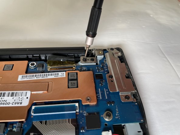

  9. Samsung Chromebook 3 XE500C13-K05US LCD Replacement: crwdns2935265:09crwdnd2935265:01crwdnd2935265:03crwdne2935265:0 Samsung Chromebook 3 XE500C13-K05US LCD Replacement: crwdns2935265:09crwdnd2935265:02crwdnd2935265:03crwdne2935265:0 Samsung Chromebook 3 XE500C13-K05US LCD Replacement: crwdns2935265:09crwdnd2935265:03crwdnd2935265:03crwdne2935265:0
    • Remove the four 4.6mm screws from the display mounts.

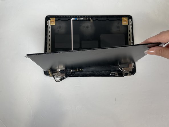

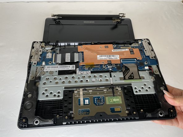

    • Once the hinge screws have been detached, open the laptop.
    • The bottom of the laptop will divide from the screen once you are able to open it a certain amount.

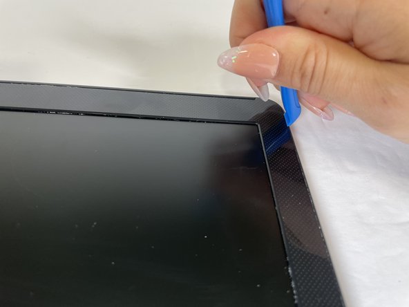

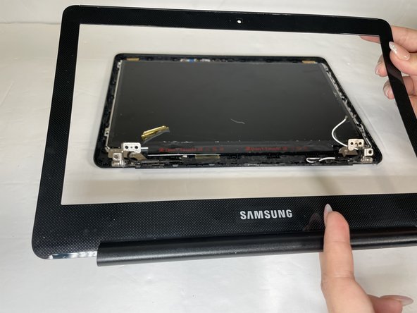

  11. Samsung Chromebook 3 XE500C13-K05US LCD Replacement: crwdns2935265:011crwdnd2935265:01crwdnd2935265:03crwdne2935265:0 Samsung Chromebook 3 XE500C13-K05US LCD Replacement: crwdns2935265:011crwdnd2935265:02crwdnd2935265:03crwdne2935265:0 Samsung Chromebook 3 XE500C13-K05US LCD Replacement: crwdns2935265:011crwdnd2935265:03crwdnd2935265:03crwdne2935265:0
    • Using the ifixit opening tool to pry in between the bezel and screen.
    • You will hear some snapping as you open the bezel with the ifixit opening tool.

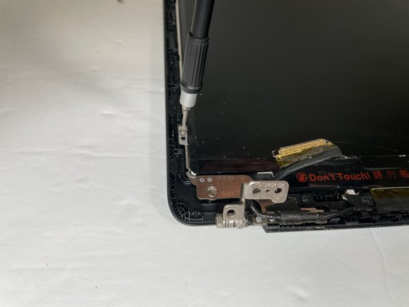

  12. Samsung Chromebook 3 XE500C13-K05US LCD Replacement: crwdns2935265:012crwdnd2935265:01crwdnd2935265:02crwdne2935265:0 Samsung Chromebook 3 XE500C13-K05US LCD Replacement: crwdns2935265:012crwdnd2935265:02crwdnd2935265:02crwdne2935265:0

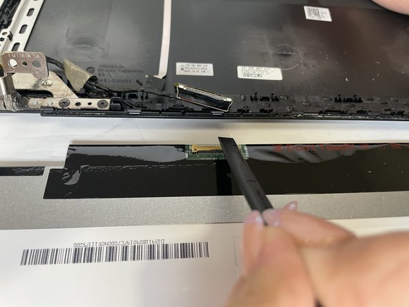

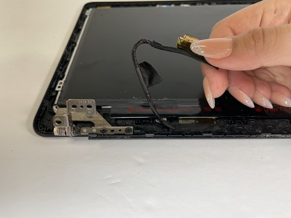

    • Using the spudger, raise the adhesive tap that is holding the display cable.
  14. Samsung Chromebook 3 XE500C13-K05US LCD Replacement: crwdns2935265:014crwdnd2935265:01crwdnd2935265:03crwdne2935265:0 Samsung Chromebook 3 XE500C13-K05US LCD Replacement: crwdns2935265:014crwdnd2935265:02crwdnd2935265:03crwdne2935265:0 Samsung Chromebook 3 XE500C13-K05US LCD Replacement: crwdns2935265:014crwdnd2935265:03crwdnd2935265:03crwdne2935265:0
    • Slowly raise the panel up and fold it over to uncover the display cable on the backside of the display.

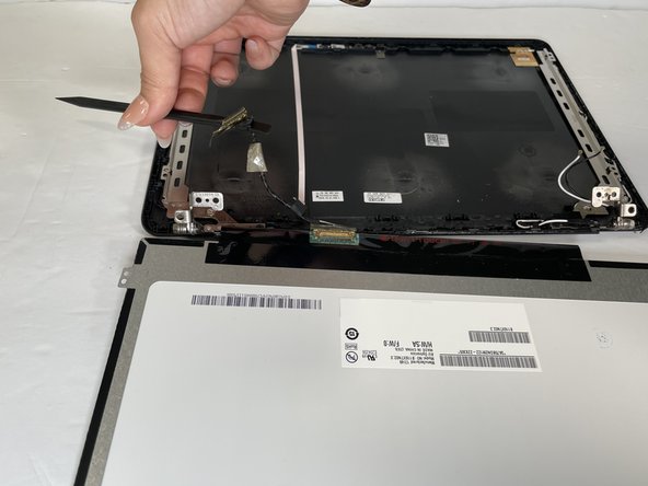

  15. Samsung Chromebook 3 XE500C13-K05US LCD Replacement: crwdns2935265:015crwdnd2935265:01crwdnd2935265:02crwdne2935265:0 Samsung Chromebook 3 XE500C13-K05US LCD Replacement: crwdns2935265:015crwdnd2935265:02crwdnd2935265:02crwdne2935265:0
    • Using the ifixit spudger, raise the hinge that is locking the gold colored display cable in place.
    • Pull the cable away from far from you to slide it out the monitor.
    • Be tender around the display circuit board, it is labeled "Do not touch."
  16. Samsung Chromebook 3 XE500C13-K05US LCD Replacement: crwdns2935265:016crwdnd2935265:01crwdnd2935265:01crwdne2935265:0
    • Once the display cable has been detached, raise the screen up and out of the case.
