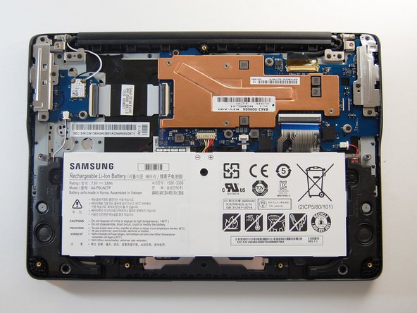

    • Remove the cover exposing the inside of the laptop.

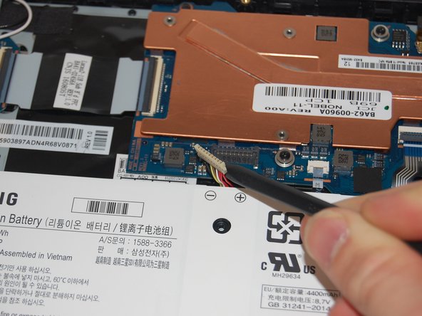

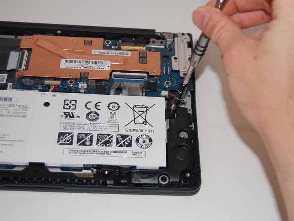

  4. Samsung Chromebook 3 XE500C13-K02US Track pad Replacement, Battery: crwdns2935265:04crwdnd2935265:01crwdnd2935265:02crwdne2935265:0 Samsung Chromebook 3 XE500C13-K02US Track pad Replacement, Battery: crwdns2935265:04crwdnd2935265:02crwdnd2935265:02crwdne2935265:0
    • Remove the four 4.6mm screws with the Phillips #00 screwdriver.

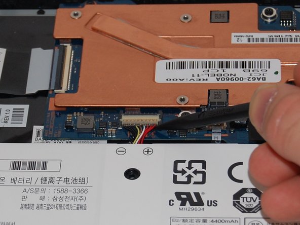

  5. Samsung Chromebook 3 XE500C13-K02US Track pad Replacement: crwdns2935265:05crwdnd2935265:01crwdnd2935265:03crwdne2935265:0 Samsung Chromebook 3 XE500C13-K02US Track pad Replacement: crwdns2935265:05crwdnd2935265:02crwdnd2935265:03crwdne2935265:0 Samsung Chromebook 3 XE500C13-K02US Track pad Replacement: crwdns2935265:05crwdnd2935265:03crwdnd2935265:03crwdne2935265:0
    • Use the spudger to pry underneath the cable and gently lift the connector up.
  6. Samsung Chromebook 3 XE500C13-K02US Track pad Replacement: crwdns2935265:06crwdnd2935265:01crwdnd2935265:01crwdne2935265:0
    • Lift the battery up and out of the case.

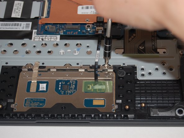

  7. Samsung Chromebook 3 XE500C13-K02US Track pad Replacement, Track pad: crwdns2935265:07crwdnd2935265:01crwdnd2935265:02crwdne2935265:0 Samsung Chromebook 3 XE500C13-K02US Track pad Replacement, Track pad: crwdns2935265:07crwdnd2935265:02crwdnd2935265:02crwdne2935265:0
    • Remove the three 2.3mm screws along the top of the trackpad using a Phillips #00 screwdriver.

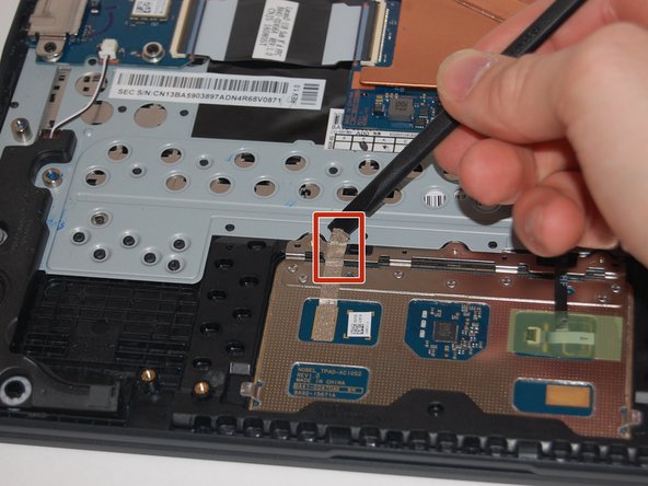

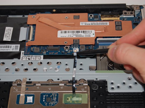

  8. Samsung Chromebook 3 XE500C13-K02US Track pad Replacement: crwdns2935265:08crwdnd2935265:01crwdnd2935265:03crwdne2935265:0 Samsung Chromebook 3 XE500C13-K02US Track pad Replacement: crwdns2935265:08crwdnd2935265:02crwdnd2935265:03crwdne2935265:0 Samsung Chromebook 3 XE500C13-K02US Track pad Replacement: crwdns2935265:08crwdnd2935265:03crwdnd2935265:03crwdne2935265:0
    • Remove the ribbon cable by lifting it out of the connector.
    • Lift the grey adhesive tape.

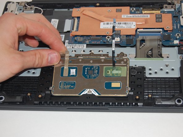

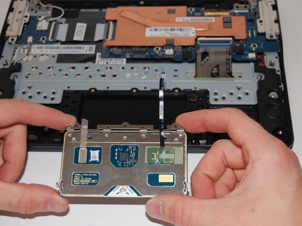

  9. Samsung Chromebook 3 XE500C13-K02US Track pad Replacement: crwdns2935265:09crwdnd2935265:01crwdnd2935265:03crwdne2935265:0 Samsung Chromebook 3 XE500C13-K02US Track pad Replacement: crwdns2935265:09crwdnd2935265:02crwdnd2935265:03crwdne2935265:0 Samsung Chromebook 3 XE500C13-K02US Track pad Replacement: crwdns2935265:09crwdnd2935265:03crwdnd2935265:03crwdne2935265:0
    • Lift the track pad from the top.
    • Slide the track pad away from yourself to clear the black plastic edge.
    • Lift the track pad up and out of the laptop.
