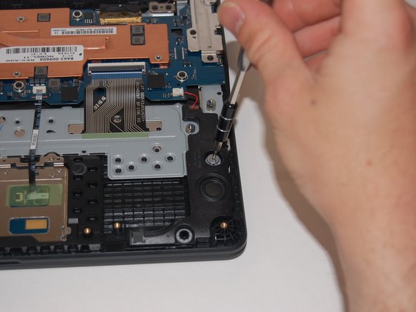

  7. Samsung Chromebook 3 XE500C13-K02US Speakers Replacement, Speakers: crwdns2935265:07crwdnd2935265:01crwdnd2935265:02crwdne2935265:0 Samsung Chromebook 3 XE500C13-K02US Speakers Replacement, Speakers: crwdns2935265:07crwdnd2935265:02crwdnd2935265:02crwdne2935265:0
    • Remove two 4.9mm silver screws with a Phillips #00 screwdriver.
    • Each speaker only has 1 screw.

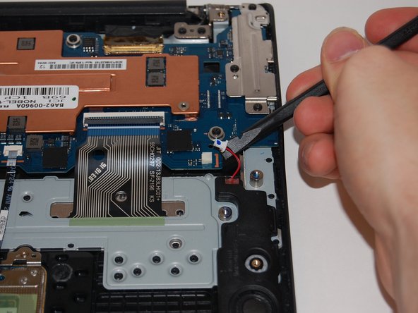

  8. Samsung Chromebook 3 XE500C13-K02US Speakers Replacement: crwdns2935265:08crwdnd2935265:01crwdnd2935265:02crwdne2935265:0 Samsung Chromebook 3 XE500C13-K02US Speakers Replacement: crwdns2935265:08crwdnd2935265:02crwdnd2935265:02crwdne2935265:0
    • Use the spudger to pry the speaker connector sideways out out of the motherboard.
    • Repeat this step for the left speaker.
