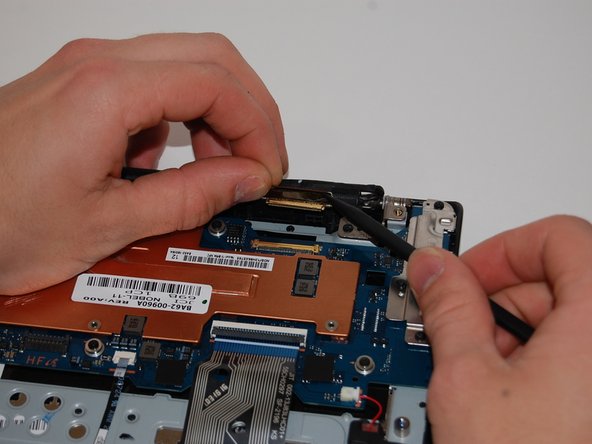

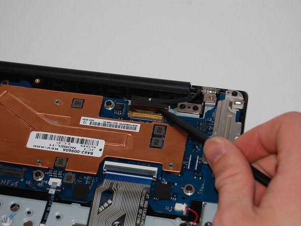

    • Use the spudger to lift the hinge locking the gold colored display cable in place.
    • Slide the cable out to remove it from the motherboard.

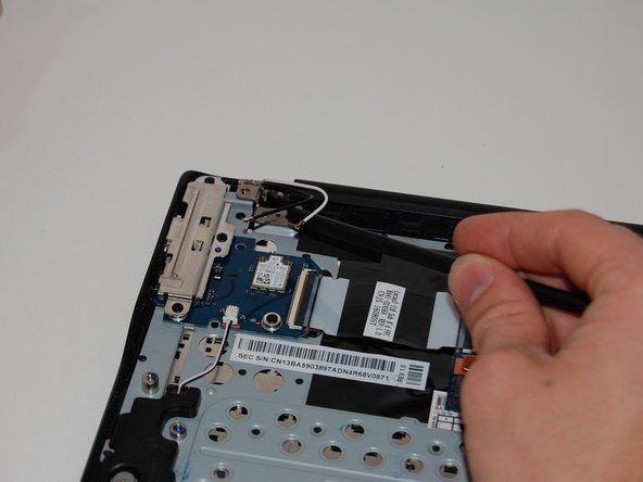

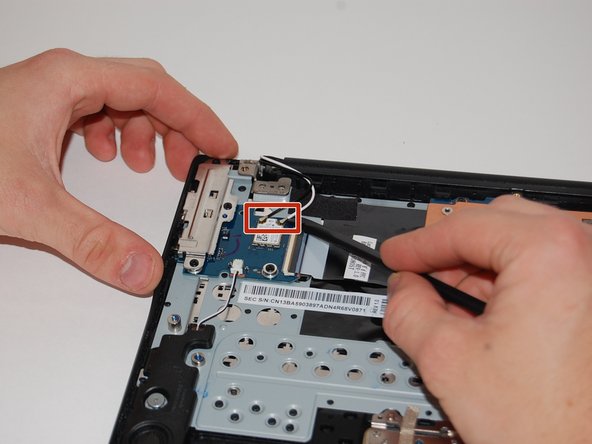

    • Using the spudger, lift the adhesive securing the wireless card antenna wires.
    • Lift the white and black antenna wires with the spudger.

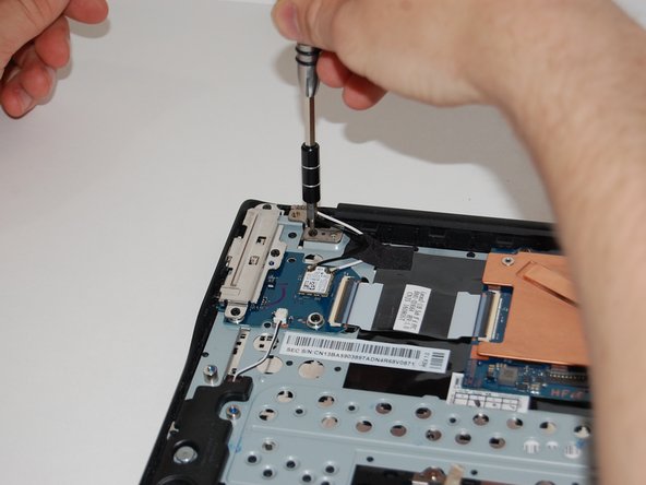

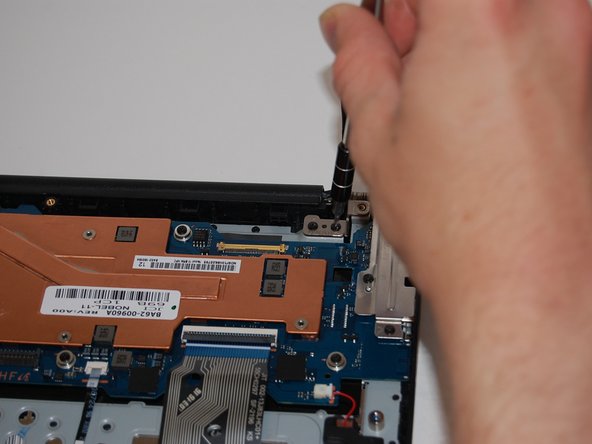

    • Remove the four 4.6mm screws from the display mounts using a Phillips #00 screwdriver.
  10. Samsung Chromebook 3 XE500C13-K02US Display Screen Replacement: crwdns2935265:010crwdnd2935265:01crwdnd2935265:03crwdne2935265:0 Samsung Chromebook 3 XE500C13-K02US Display Screen Replacement: crwdns2935265:010crwdnd2935265:02crwdnd2935265:03crwdne2935265:0 Samsung Chromebook 3 XE500C13-K02US Display Screen Replacement: crwdns2935265:010crwdnd2935265:03crwdnd2935265:03crwdne2935265:0

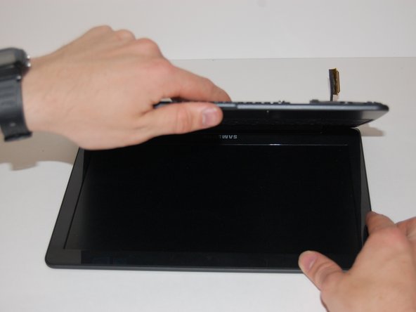

    • Once the hinge screws have been removed, open the laptop.
    • The laptop bottom will separate from the screen once you open it a certain amount.

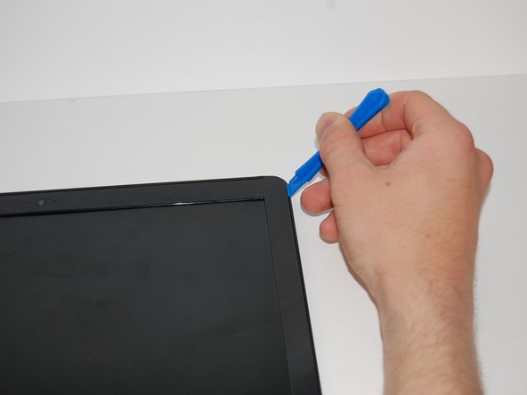

    • Use the iFixit opening tool to pry in between the bezel and screen.
    • You will hear a snapping sound as you work your way around the bezel with the iFixit opening tool.

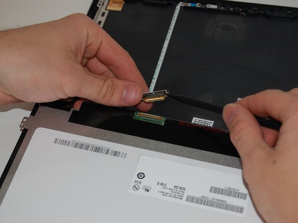

  14. Samsung Chromebook 3 XE500C13-K02US Display Screen Replacement: crwdns2935265:014crwdnd2935265:01crwdnd2935265:03crwdne2935265:0 Samsung Chromebook 3 XE500C13-K02US Display Screen Replacement: crwdns2935265:014crwdnd2935265:02crwdnd2935265:03crwdne2935265:0 Samsung Chromebook 3 XE500C13-K02US Display Screen Replacement: crwdns2935265:014crwdnd2935265:03crwdnd2935265:03crwdne2935265:0
    • Gently lift the panel up and fold it over to expose the display cable on the backside of the display.
  15. Samsung Chromebook 3 XE500C13-K02US Display Screen Replacement: crwdns2935265:015crwdnd2935265:01crwdnd2935265:03crwdne2935265:0 Samsung Chromebook 3 XE500C13-K02US Display Screen Replacement: crwdns2935265:015crwdnd2935265:02crwdnd2935265:03crwdne2935265:0 Samsung Chromebook 3 XE500C13-K02US Display Screen Replacement: crwdns2935265:015crwdnd2935265:03crwdnd2935265:03crwdne2935265:0

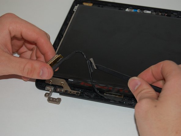

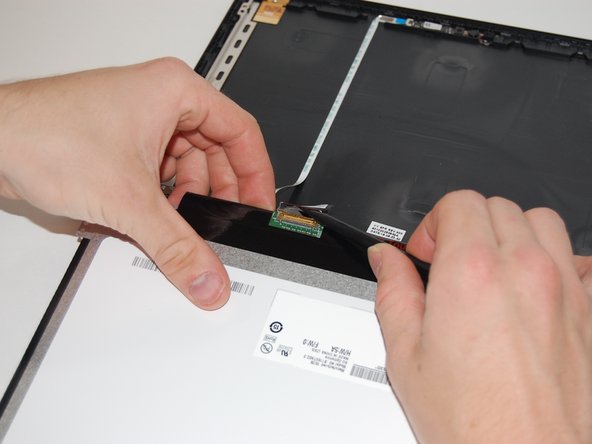

    • Use the spudger, lift the hinge locking the gold colored display cable in place.
    • Pull the cable away from you to slide it out of the monitor.
    • Be gentle around the display circuit board. It is labeled "Do not touch."

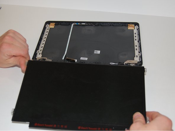

  16. Samsung Chromebook 3 XE500C13-K02US Display Screen Replacement: crwdns2935265:016crwdnd2935265:01crwdnd2935265:01crwdne2935265:0
    • Once the display cable has been removed, lift the screen up and out of the case.

It was more challenging than I thought. Reconnecting the antenna wires wasn’t easy. I needed better vision and dexterity to find it easier. Don’t forget to reuse the adhesive tape or you may be disappointed.
