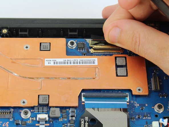

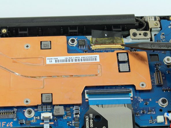

      • Disengage the gold connector joining the display and motherboard by flipping up the hinge with a spudger and gently disconnecting it with a spudger or your fingers.

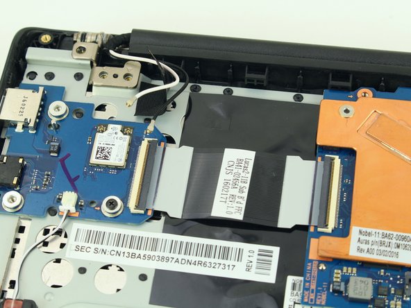

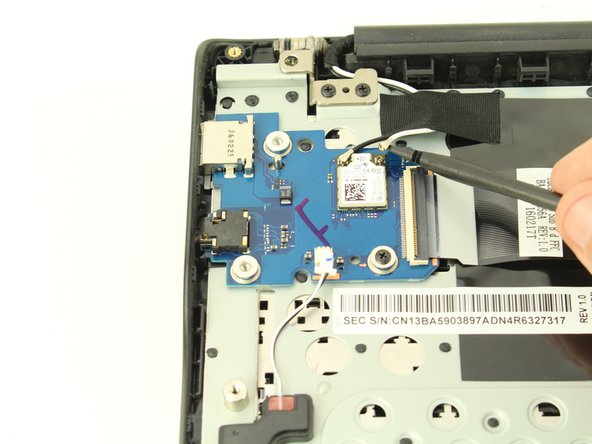

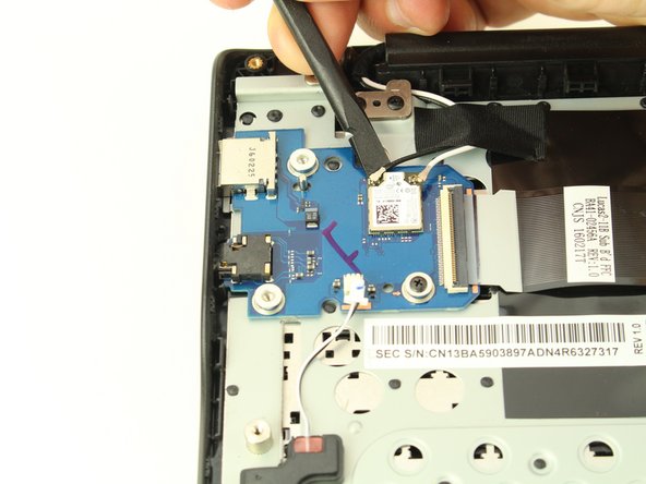

      • Next disconnect the small coaxial cables from the wireless chip on the daughterboard by prying upwards with a spudger.
    3. Samsung Chromebook 3 Display Replacement: crwdns2935265:09crwdnd2935265:01crwdnd2935265:02crwdne2935265:0 Samsung Chromebook 3 Display Replacement: crwdns2935265:09crwdnd2935265:02crwdnd2935265:02crwdne2935265:0
      • Flip up at least one side of the adhesive tape holding the coaxial cables in place. When the display is removed, the cables are coming with it!

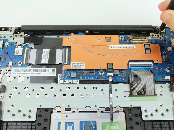

      • Finally, remove the four 4.6mm screws from the display mounts using a Phillips #00 screwdriver.
      • It might be easier to open the laptop before removing these screws as the display will only come off while in the open position.
    5. Samsung Chromebook 3 Display Replacement: crwdns2935265:011crwdnd2935265:01crwdnd2935265:01crwdne2935265:0
      • Open the laptop and remove the display.

Any idea as to what kind of connector the display has to the motherboard? Or how many pins? Trying to tear down the display and see if I can use it as an extra monitor.
Sam Rall - crwdns2934203:0crwdne2934203:0 crwdns2950251:0crwdne2950251:0
It looks like there are 40 pins on the display connector. I’m not sure what it would be called or if it’s any kind of standard. If you do manage to convert the display to an extra monitor, you should definitely let us know though!
