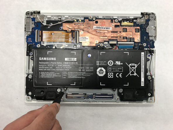

    • Remove the four 3 mm screws using a Phillips #000 screwdriver.
  5. Samsung Chromebook 2 XE503c12 Trackpad Replacement: crwdns2935265:05crwdnd2935265:01crwdnd2935265:02crwdne2935265:0 Samsung Chromebook 2 XE503c12 Trackpad Replacement: crwdns2935265:05crwdnd2935265:02crwdnd2935265:02crwdne2935265:0

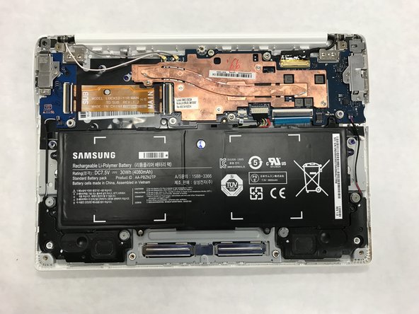

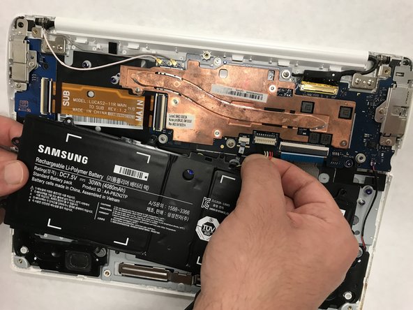

    • Carefully lift the top of the battery then pull it away from you to remove it.
    • Some batteries may be attached via a battery connector. Disconnect the battery connector by simply pulling straight up at its base.

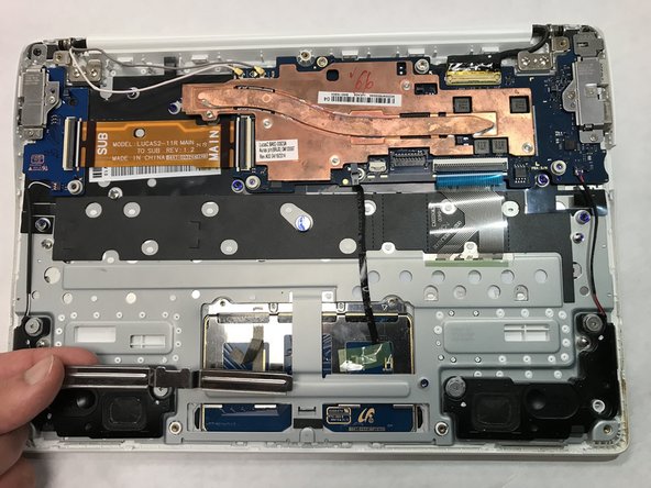

    • Using a Phillips #00 screwdriver, remove all of the two screws keeping the trackpad in place.

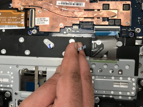

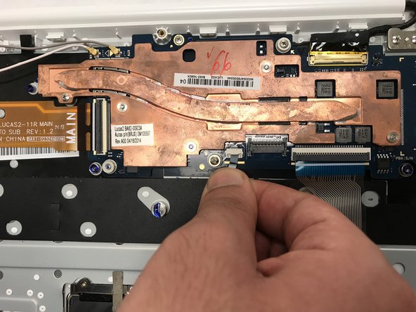

  7. Samsung Chromebook 2 XE503c12 Trackpad Replacement: crwdns2935265:07crwdnd2935265:01crwdnd2935265:03crwdne2935265:0 Samsung Chromebook 2 XE503c12 Trackpad Replacement: crwdns2935265:07crwdnd2935265:02crwdnd2935265:03crwdne2935265:0 Samsung Chromebook 2 XE503c12 Trackpad Replacement: crwdns2935265:07crwdnd2935265:03crwdnd2935265:03crwdne2935265:0
    • Gently remove the connector between the trackpad and the motherboard by pulling upward on it at the port.

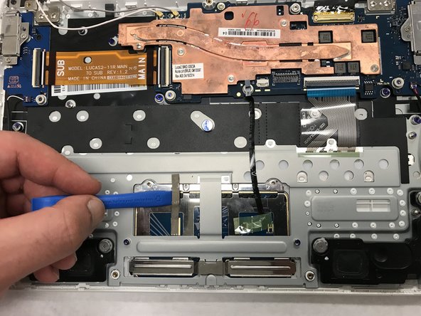

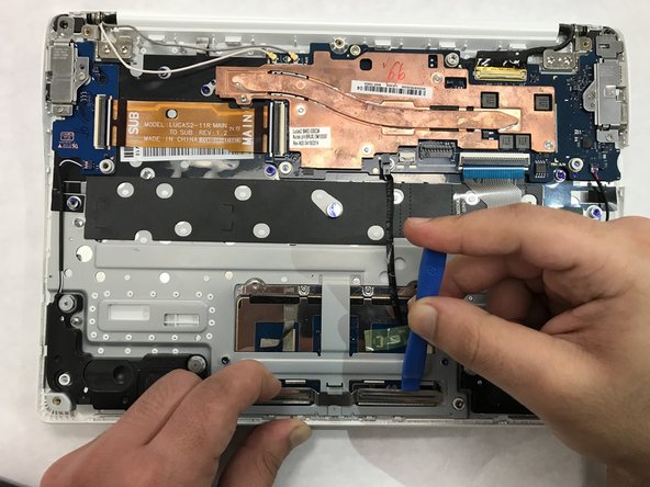

  8. Samsung Chromebook 2 XE503c12 Trackpad Replacement: crwdns2935265:08crwdnd2935265:01crwdnd2935265:02crwdne2935265:0 Samsung Chromebook 2 XE503c12 Trackpad Replacement: crwdns2935265:08crwdnd2935265:02crwdnd2935265:02crwdne2935265:0
    • Using an opening tool, gently peel back the adhesive strip holding the trackpad in place.

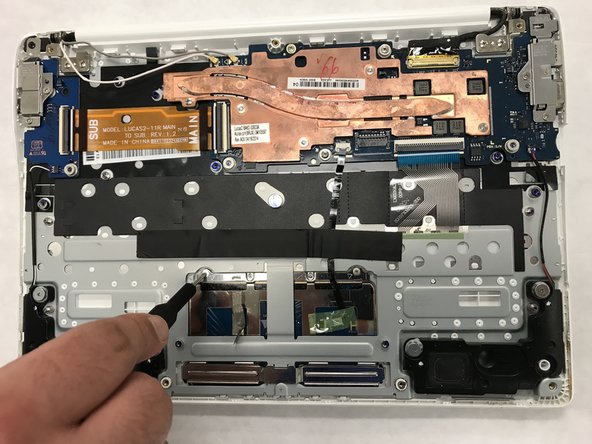

    • Using the opening tool, disconnect the metal trackpad support brackets.
    • Don't be afraid to use a moderate amount of force when prying the support brackets loose.

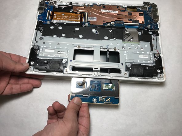

  10. Samsung Chromebook 2 XE503c12 Trackpad Replacement: crwdns2935265:010crwdnd2935265:01crwdnd2935265:02crwdne2935265:0 Samsung Chromebook 2 XE503c12 Trackpad Replacement: crwdns2935265:010crwdnd2935265:02crwdnd2935265:02crwdne2935265:0
    • With the laptop slightly open, push the trackpad upwards at the rear, and pull it out from the bottom.
