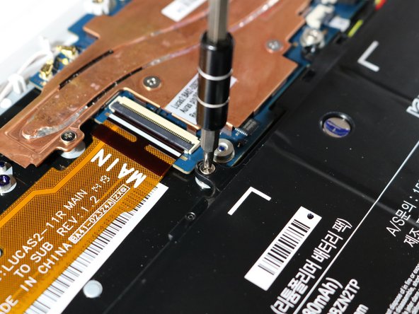

    • Remove four, 5mm Phillips #0 screws connecting the battery to the laptop
  4. Samsung Chromebook 2 XE503c12 Speakers Replacement: crwdns2935265:04crwdnd2935265:01crwdnd2935265:01crwdne2935265:0
    • Lift the battery, and pull it up and towards you, away from the connector.

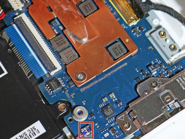

  5. Samsung Chromebook 2 XE503c12 Speakers Replacement: crwdns2935265:05crwdnd2935265:01crwdnd2935265:01crwdne2935265:0
    • Using a plastic opening tool, pry the connector up from the contact.
    • Remove the battery from the device.

    • Remove the connectors for each speaker.
