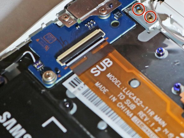

    • Remove the four 5mm Phillips #0 screws on the hinges.

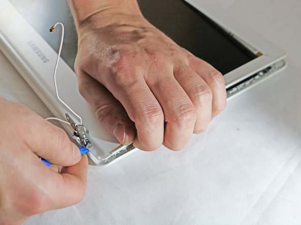

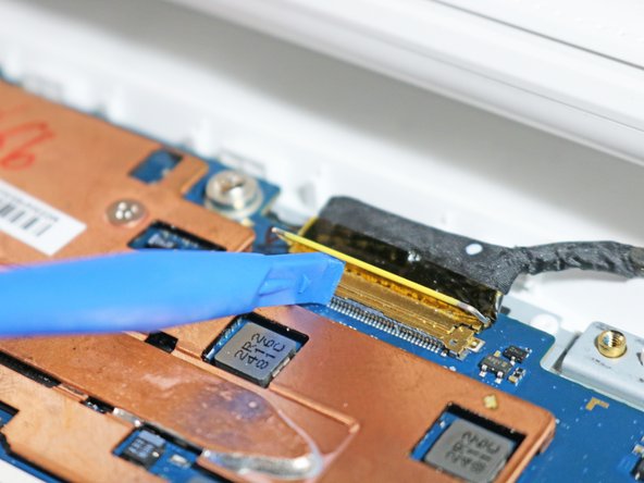

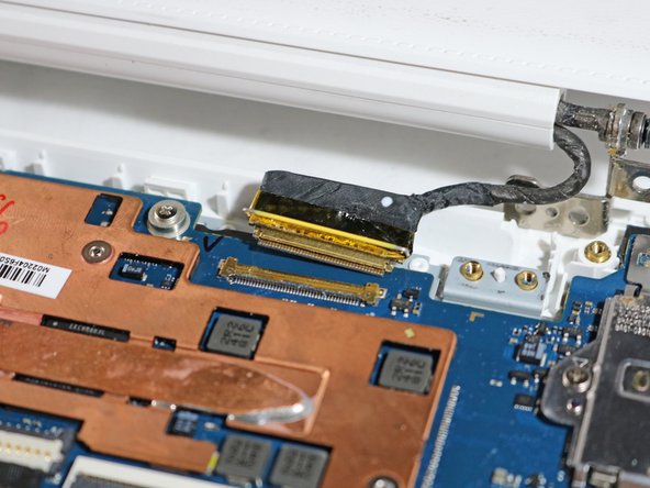

    • Unplug two auxiliary wires leading to the top lid.
    • Using the plastic prying tool, lift the hinge on the connector up and pull the connector away.

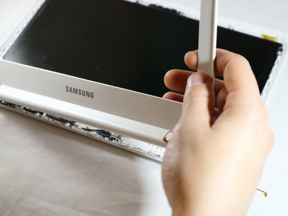

    • Using the plastic prying tool, carefully pry the casing apart from the screen.
    • When prying case apart, there is a risk of screen and parts of the casing shattering and cutting you.
