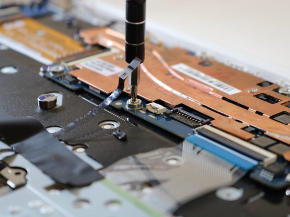

    • Locate the motherboard at top right of chromebook.
    • Remove four 9mm Phillips #0 screws and two 7mm Phillips #0 screws.

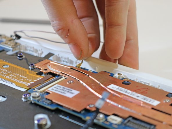

  7. Samsung Chromebook 2 XE503c12 Motherboard Replacement: crwdns2935265:07crwdnd2935265:01crwdnd2935265:02crwdne2935265:0 Samsung Chromebook 2 XE503c12 Motherboard Replacement: crwdns2935265:07crwdnd2935265:02crwdnd2935265:02crwdne2935265:0
    • Remove auxiliary wires for microphone and webcam.

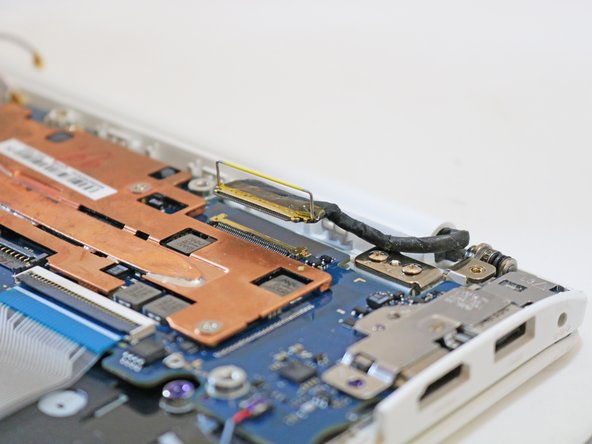

  8. Samsung Chromebook 2 XE503c12 Motherboard Replacement: crwdns2935265:08crwdnd2935265:01crwdnd2935265:02crwdne2935265:0 Samsung Chromebook 2 XE503c12 Motherboard Replacement: crwdns2935265:08crwdnd2935265:02crwdnd2935265:02crwdne2935265:0
    • Lift hinge on connector up and pull the connector away from the device.
