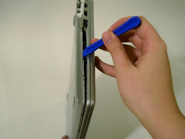

    3. Samsung Chromebook 2 Trackpad Replacement: crwdns2935265:03crwdnd2935265:01crwdnd2935265:02crwdne2935265:0 Samsung Chromebook 2 Trackpad Replacement: crwdns2935265:03crwdnd2935265:02crwdnd2935265:02crwdne2935265:0
      • Loosen the back cover panel with a plastic opening tool, and work it all the way around the computer.
    4. Samsung Chromebook 2 Trackpad Replacement: crwdns2935265:04crwdnd2935265:01crwdnd2935265:02crwdne2935265:0 Samsung Chromebook 2 Trackpad Replacement: crwdns2935265:04crwdnd2935265:02crwdnd2935265:02crwdne2935265:0
      • Once the cover is loose, remove the back cover panel using your hands.

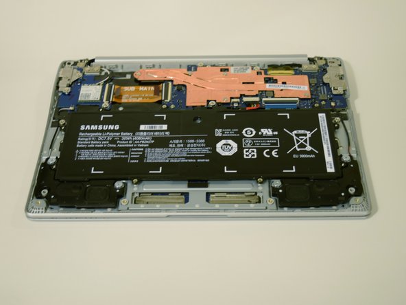

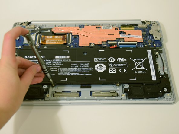

    5. Samsung Chromebook 2 Trackpad Replacement: crwdns2935265:05crwdnd2935265:01crwdnd2935265:02crwdne2935265:0 Samsung Chromebook 2 Trackpad Replacement: crwdns2935265:05crwdnd2935265:02crwdnd2935265:02crwdne2935265:0
      • Unscrew the four 4 mm screws holding the battery in place with a Phillips #0 screwdriver.

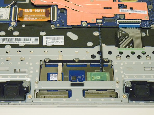

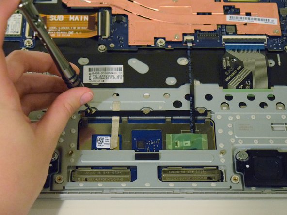

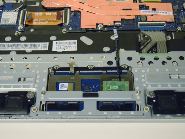

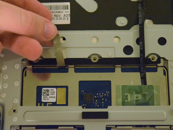

    1. Samsung Chromebook 2 Trackpad Replacement, Trackpad: crwdns2935265:07crwdnd2935265:01crwdnd2935265:03crwdne2935265:0 Samsung Chromebook 2 Trackpad Replacement, Trackpad: crwdns2935265:07crwdnd2935265:02crwdnd2935265:03crwdne2935265:0 Samsung Chromebook 2 Trackpad Replacement, Trackpad: crwdns2935265:07crwdnd2935265:03crwdnd2935265:03crwdne2935265:0
      • Using the Phillips #00 screwdriver, remove the three 2 mm screws keeping the trackpad in place.

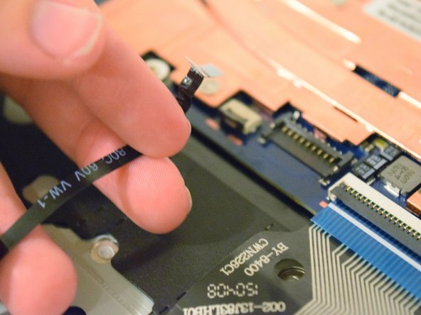

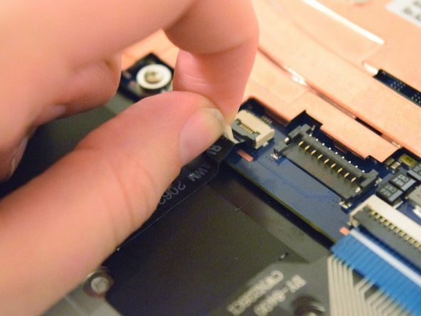

    2. Samsung Chromebook 2 Trackpad Replacement: crwdns2935265:08crwdnd2935265:01crwdnd2935265:03crwdne2935265:0 Samsung Chromebook 2 Trackpad Replacement: crwdns2935265:08crwdnd2935265:02crwdnd2935265:03crwdne2935265:0 Samsung Chromebook 2 Trackpad Replacement: crwdns2935265:08crwdnd2935265:03crwdnd2935265:03crwdne2935265:0
      • Remove the connector between the trackpad and the motherboard by pulling upwards on it at the port.

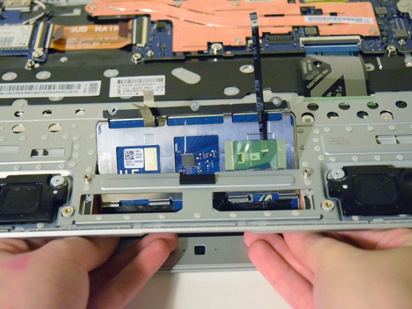

    4. Samsung Chromebook 2 Trackpad Replacement: crwdns2935265:010crwdnd2935265:01crwdnd2935265:02crwdne2935265:0 Samsung Chromebook 2 Trackpad Replacement: crwdns2935265:010crwdnd2935265:02crwdnd2935265:02crwdne2935265:0
      • Use a plastic opening tool to disconnect the metal trackpad support brackets.
      • Don't be afraid to use a moderate amount of force when prying the support brackets loose.

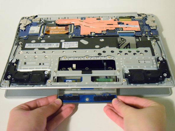

    5. Samsung Chromebook 2 Trackpad Replacement: crwdns2935265:011crwdnd2935265:01crwdnd2935265:03crwdne2935265:0 Samsung Chromebook 2 Trackpad Replacement: crwdns2935265:011crwdnd2935265:02crwdnd2935265:03crwdne2935265:0 Samsung Chromebook 2 Trackpad Replacement: crwdns2935265:011crwdnd2935265:03crwdnd2935265:03crwdne2935265:0
      • With the laptop slightly open, push the trackpad upwards at the rear, and pull it out from the bottom.

Reassembly Note: It should be noted that the trackpad will not "click" if the 2mm screws in STEP 7 are tight. Screw down until just snug then back off slightly. The bracket will then function correctly to return the trackpad to the up position after each click depress.
