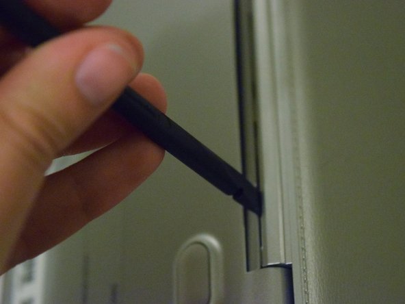

    3. Samsung Chromebook 2 Screen Replacement: crwdns2935265:09crwdnd2935265:01crwdnd2935265:02crwdne2935265:0 Samsung Chromebook 2 Screen Replacement: crwdns2935265:09crwdnd2935265:02crwdnd2935265:02crwdne2935265:0
      • Flip the computer over so that the keys and screen are facing down.
      • Insert the spudger between the back and front panel, at the hinge, and push the trim out.

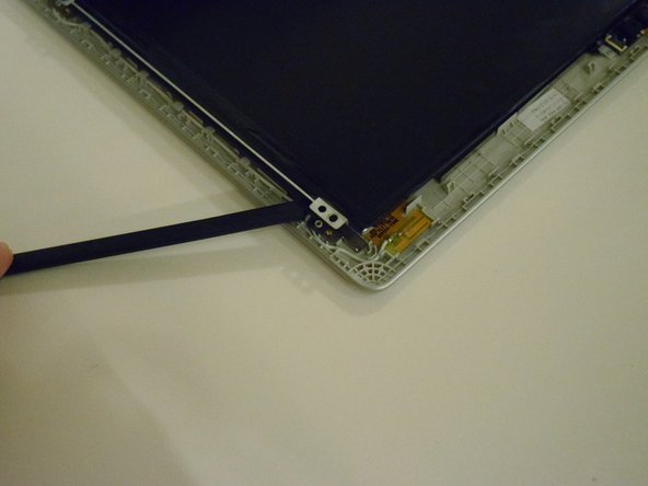

      • Using the spudger, pry the screen loose from the front panel.
      • Do not try to remove the screen yet, it is still connect by a wire.
