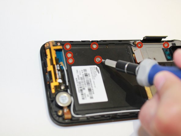

    3. Samsung Captivate Glide Screen Replacement: crwdns2935265:03crwdnd2935265:01crwdnd2935265:02crwdne2935265:0 Samsung Captivate Glide Screen Replacement: crwdns2935265:03crwdnd2935265:02crwdnd2935265:02crwdne2935265:0
      • Remove the seven screws from backplate using the #00 screwdriver.

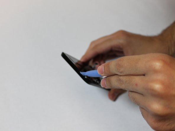

    4. Samsung Captivate Glide Screen Replacement: crwdns2935265:04crwdnd2935265:01crwdnd2935265:03crwdne2935265:0 Samsung Captivate Glide Screen Replacement: crwdns2935265:04crwdnd2935265:02crwdnd2935265:03crwdne2935265:0 Samsung Captivate Glide Screen Replacement: crwdns2935265:04crwdnd2935265:03crwdnd2935265:03crwdne2935265:0

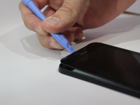

      • Remove the back plate using the plastic opening tool.
      • There is a lip on each side, and both must be pried up.
      • You can work your way around the edges after prying the two sides.

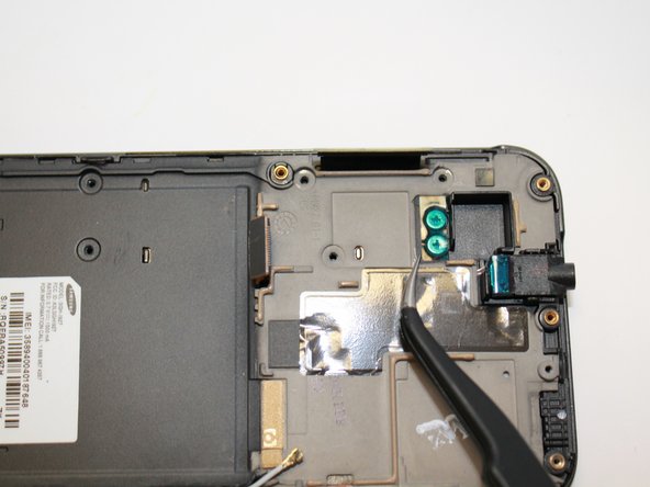

    6. Samsung Captivate Glide Screen Replacement: crwdns2935265:06crwdnd2935265:01crwdnd2935265:01crwdne2935265:0
      • Disconnect the antenna cable from the motherboard using tweezers.

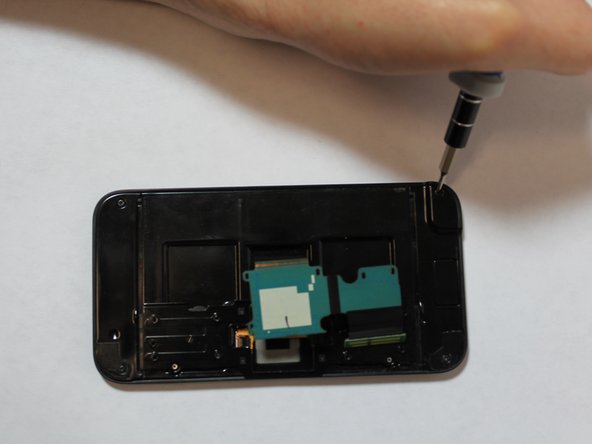

    1. Samsung Captivate Glide Screen Replacement, Screen: crwdns2935265:09crwdnd2935265:01crwdnd2935265:02crwdne2935265:0 Samsung Captivate Glide Screen Replacement, Screen: crwdns2935265:09crwdnd2935265:02crwdnd2935265:02crwdne2935265:0
      • Remove the eight screws with the #00 screwdriver.
    2. Samsung Captivate Glide Screen Replacement: crwdns2935265:010crwdnd2935265:01crwdnd2935265:02crwdne2935265:0 Samsung Captivate Glide Screen Replacement: crwdns2935265:010crwdnd2935265:02crwdnd2935265:02crwdne2935265:0
    3. Samsung Captivate Glide Screen Replacement: crwdns2935265:011crwdnd2935265:01crwdnd2935265:01crwdne2935265:0
      • Remove screws with the #00 screwdriver.

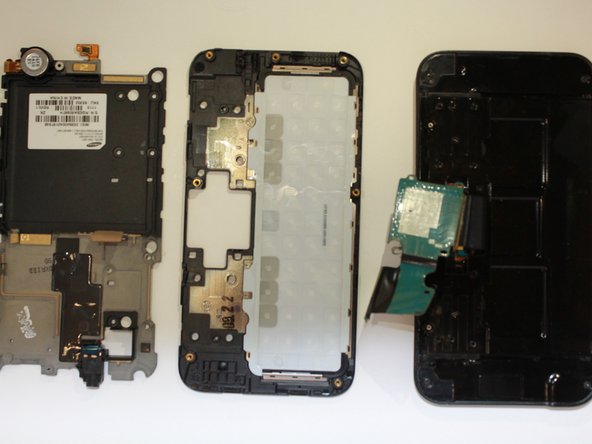

    4. Samsung Captivate Glide Screen Replacement: crwdns2935265:012crwdnd2935265:01crwdnd2935265:01crwdne2935265:0
      • Using the plastic opening tool, remove the back plate by prying on the four main points.
      • You may encounter difficultly at certain points. Work the plastic opening tool along the edge to keep back plate from closing again.

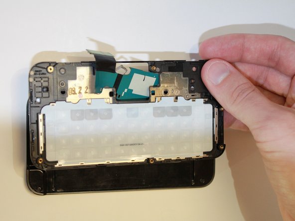

    5. Samsung Captivate Glide Screen Replacement: crwdns2935265:013crwdnd2935265:01crwdnd2935265:01crwdne2935265:0
      • Lift the back plate.
      • To remove to slide flex cable, gently peel back from the back plate and remove back plate.
    6. Samsung Captivate Glide Screen Replacement: crwdns2935265:014crwdnd2935265:01crwdnd2935265:03crwdne2935265:0 Samsung Captivate Glide Screen Replacement: crwdns2935265:014crwdnd2935265:02crwdnd2935265:03crwdne2935265:0 Samsung Captivate Glide Screen Replacement: crwdns2935265:014crwdnd2935265:03crwdnd2935265:03crwdne2935265:0
      • Slide the flex cable through the slot. Be careful to not tear the cable.
      • Set the front plate down.

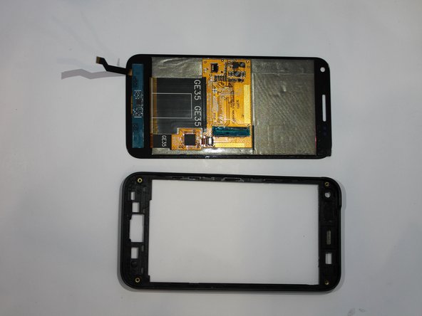

    8. Samsung Captivate Glide Screen Replacement: crwdns2935265:016crwdnd2935265:01crwdnd2935265:03crwdne2935265:0 Samsung Captivate Glide Screen Replacement: crwdns2935265:016crwdnd2935265:02crwdnd2935265:03crwdne2935265:0 Samsung Captivate Glide Screen Replacement: crwdns2935265:016crwdnd2935265:03crwdnd2935265:03crwdne2935265:0
      • Using the plastic opening tool, release all the clips on all four sides holding the screen assembly.
      • You can now remove the back plate by sliding the flex cable through the slot.

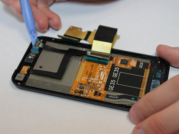

    9. Samsung Captivate Glide Screen Replacement: crwdns2935265:017crwdnd2935265:01crwdnd2935265:03crwdne2935265:0 Samsung Captivate Glide Screen Replacement: crwdns2935265:017crwdnd2935265:02crwdnd2935265:03crwdne2935265:0 Samsung Captivate Glide Screen Replacement: crwdns2935265:017crwdnd2935265:03crwdnd2935265:03crwdne2935265:0
      • Use the plastic opening tool to release the main jaw connector, front speaker and camera.

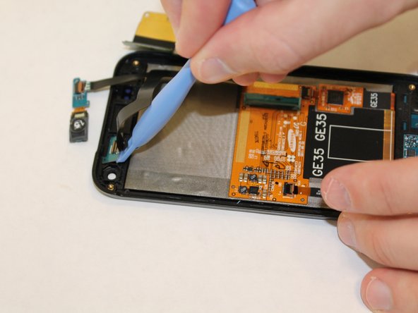

    10. Samsung Captivate Glide Screen Replacement: crwdns2935265:018crwdnd2935265:01crwdnd2935265:02crwdne2935265:0 Samsung Captivate Glide Screen Replacement: crwdns2935265:018crwdnd2935265:02crwdnd2935265:02crwdne2935265:0
      • By using the plastic opening tool you can release the keypad flex cable from the jaw connecter clamp.

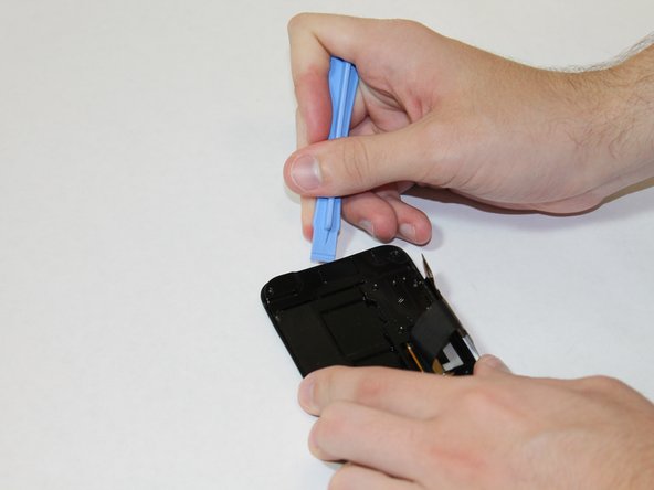

      • Use a heat gun or blow dryer.
      • Heat the outside edges using quick movements for about 45 seconds.

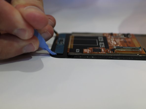

    12. Samsung Captivate Glide Screen Replacement: crwdns2935265:020crwdnd2935265:01crwdnd2935265:03crwdne2935265:0 Samsung Captivate Glide Screen Replacement: crwdns2935265:020crwdnd2935265:02crwdnd2935265:03crwdne2935265:0 Samsung Captivate Glide Screen Replacement: crwdns2935265:020crwdnd2935265:03crwdnd2935265:03crwdne2935265:0
      • Using the plastic opening tool to pry around the edges, release the touch screen from the screen frame.

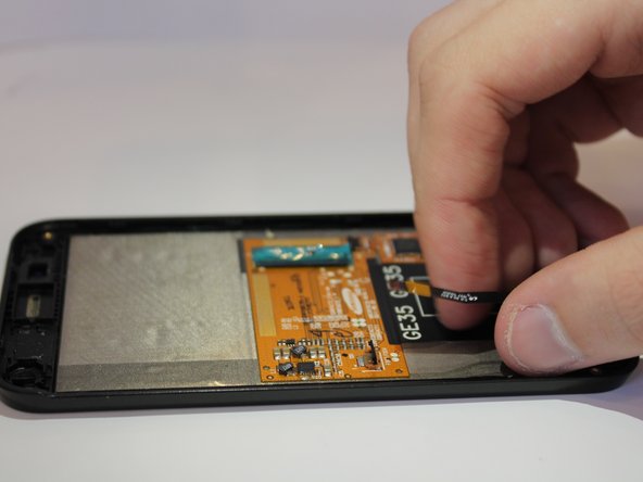

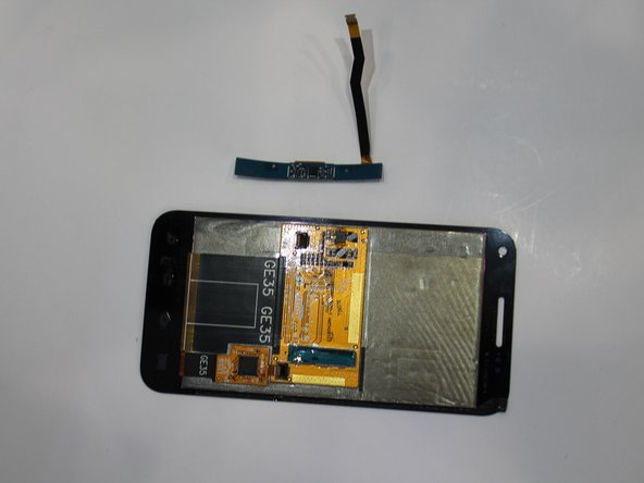

    13. Samsung Captivate Glide Screen Replacement: crwdns2935265:021crwdnd2935265:01crwdnd2935265:03crwdne2935265:0 Samsung Captivate Glide Screen Replacement: crwdns2935265:021crwdnd2935265:02crwdnd2935265:03crwdne2935265:0 Samsung Captivate Glide Screen Replacement: crwdns2935265:021crwdnd2935265:03crwdnd2935265:03crwdne2935265:0
      • While adhesive is still warm, use the plastic opening tool to gently remove the keyboard flex cable from the screen.
      • You can now replace the screen assembly.
