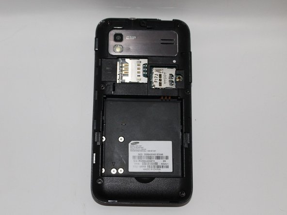

    • Remove back cover using fingernail or plastic opening tool. The cover pulls up and off.
  2. Samsung Captivate Glide QWERTY Keyboard Replacement: crwdns2935265:02crwdnd2935265:01crwdnd2935265:02crwdne2935265:0 Samsung Captivate Glide QWERTY Keyboard Replacement: crwdns2935265:02crwdnd2935265:02crwdnd2935265:02crwdne2935265:0
    • Remove battery with plastic opening tool or finger.

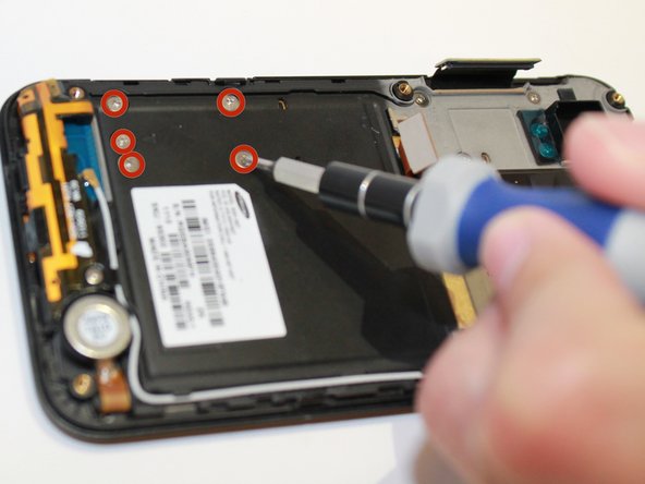

  3. Samsung Captivate Glide QWERTY Keyboard Replacement: crwdns2935265:03crwdnd2935265:01crwdnd2935265:02crwdne2935265:0 Samsung Captivate Glide QWERTY Keyboard Replacement: crwdns2935265:03crwdnd2935265:02crwdnd2935265:02crwdne2935265:0
    • Remove the seven screws from backplate using the #00 screwdriver.

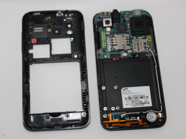

  4. Samsung Captivate Glide QWERTY Keyboard Replacement: crwdns2935265:04crwdnd2935265:01crwdnd2935265:03crwdne2935265:0 Samsung Captivate Glide QWERTY Keyboard Replacement: crwdns2935265:04crwdnd2935265:02crwdnd2935265:03crwdne2935265:0 Samsung Captivate Glide QWERTY Keyboard Replacement: crwdns2935265:04crwdnd2935265:03crwdnd2935265:03crwdne2935265:0
    • Remove the back plate using the plastic opening tool.
    • There is a lip on each side, and both must be pried up.
    • You can work your way around the edges after prying the two sides.

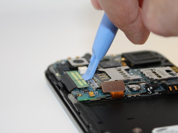

  5. Samsung Captivate Glide QWERTY Keyboard Replacement: crwdns2935265:05crwdnd2935265:01crwdnd2935265:02crwdne2935265:0 Samsung Captivate Glide QWERTY Keyboard Replacement: crwdns2935265:05crwdnd2935265:02crwdnd2935265:02crwdne2935265:0
    • Use the plastic opening tool to detach the two tabs connecting the motherboard to the base of the phone.

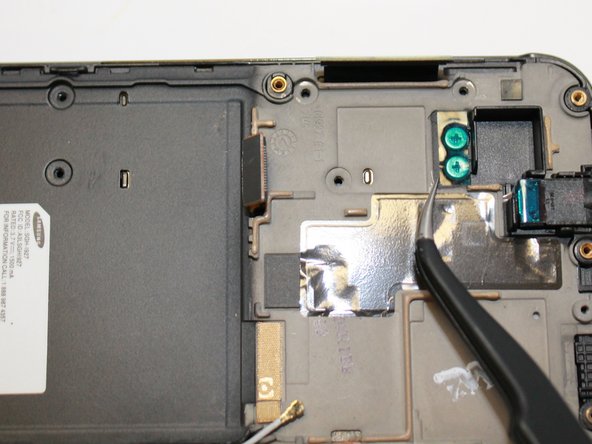

  6. Samsung Captivate Glide QWERTY Keyboard Replacement: crwdns2935265:06crwdnd2935265:01crwdnd2935265:01crwdne2935265:0
    • Disconnect the antenna cable from the motherboard using tweezers.
  7. Samsung Captivate Glide QWERTY Keyboard Replacement: crwdns2935265:07crwdnd2935265:01crwdnd2935265:01crwdne2935265:0
    • Remove the single screw connecting the motherboard to the base of the phone by using the #00 Phillips screwdriver.

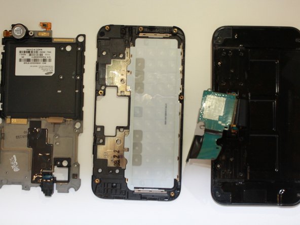

  12. Samsung Captivate Glide QWERTY Keyboard Replacement: crwdns2935265:012crwdnd2935265:01crwdnd2935265:01crwdne2935265:0
    • Using the plastic opening tool, remove the back plate by prying on the four main points.
    • You may encounter difficultly at certain points. Work the plastic opening tool along the edge to keep back plate from closing again.

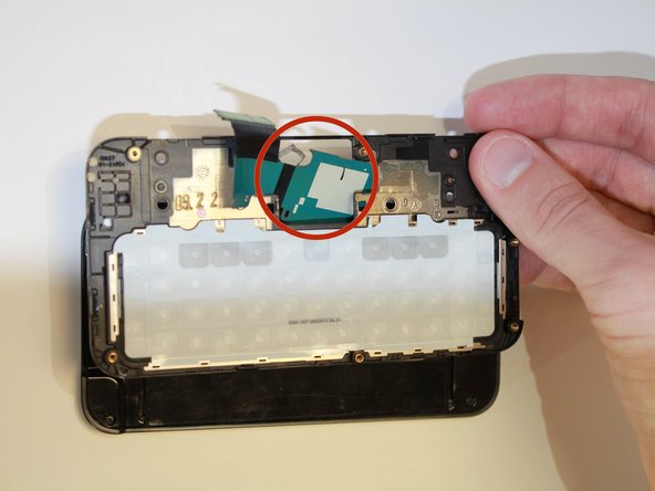

  13. Samsung Captivate Glide QWERTY Keyboard Replacement: crwdns2935265:013crwdnd2935265:01crwdnd2935265:01crwdne2935265:0
    • Lift the back plate.
    • To remove the attached flex cable, gently peel the flex cable connecting to the back plate.
    • Flex cable is attached to the back plate with an adhesive.
  14. Samsung Captivate Glide QWERTY Keyboard Replacement: crwdns2935265:014crwdnd2935265:01crwdnd2935265:03crwdne2935265:0 Samsung Captivate Glide QWERTY Keyboard Replacement: crwdns2935265:014crwdnd2935265:02crwdnd2935265:03crwdne2935265:0 Samsung Captivate Glide QWERTY Keyboard Replacement: crwdns2935265:014crwdnd2935265:03crwdnd2935265:03crwdne2935265:0
    • Slide the flex cable through the slot.
    • Set the front plate down. Now you have free access to the keyboard.
  15. Samsung Captivate Glide QWERTY Keyboard Replacement: crwdns2935265:015crwdnd2935265:01crwdnd2935265:01crwdne2935265:0
    • Manually lift the keyboard and replace with new keyboard.
    • Make sure the new keyboard is placed with the keyboard letters facing down, and the white back facing up.
