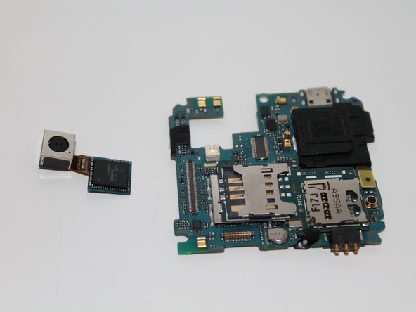

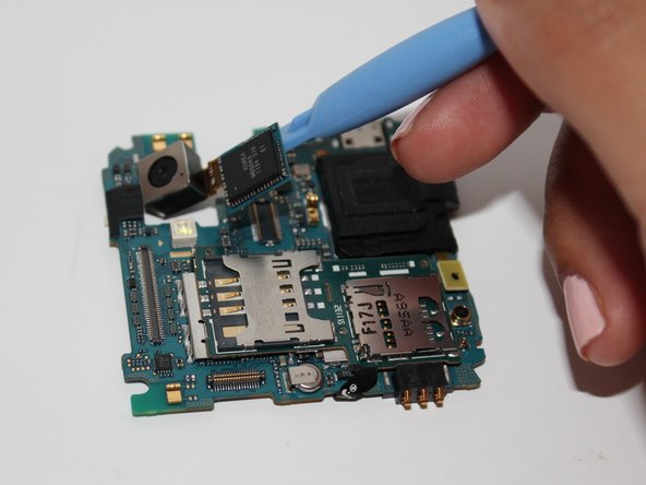

    1. Samsung Captivate Glide Camera Replacement, Camera: crwdns2935265:09crwdnd2935265:01crwdnd2935265:03crwdne2935265:0 Samsung Captivate Glide Camera Replacement, Camera: crwdns2935265:09crwdnd2935265:02crwdnd2935265:03crwdne2935265:0 Samsung Captivate Glide Camera Replacement, Camera: crwdns2935265:09crwdnd2935265:03crwdnd2935265:03crwdne2935265:0
      • Using the opening tool, pry up the camera attachment from the motherboard.
