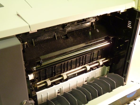

    • Turn the printer off and wait a few minutes for it to cool.
    • Turn printer around so that you are looking at the rear panel.
  2. Samsung CLP-300 Fuser Unit Replacement: crwdns2935265:02crwdnd2935265:01crwdnd2935265:01crwdne2935265:0
    • Open back of printer by pushing down handle.
  3. Samsung CLP-300 Fuser Unit Replacement: crwdns2935265:03crwdnd2935265:01crwdnd2935265:02crwdne2935265:0 Samsung CLP-300 Fuser Unit Replacement: crwdns2935265:03crwdnd2935265:02crwdnd2935265:02crwdne2935265:0
    • Remove the four screws that attach the fuser unit to the printer.
  4. Samsung CLP-300 Fuser Unit Replacement: crwdns2935265:04crwdnd2935265:01crwdnd2935265:02crwdne2935265:0 Samsung CLP-300 Fuser Unit Replacement: crwdns2935265:04crwdnd2935265:02crwdnd2935265:02crwdne2935265:0
    • Slide fuser unit out of the printer.
    • Remove packaging from new fuser unit.
    • Insert new fuser unit.

how do you unplug the old fuser unit and plug in the new fuser unit - you don’t show how to do that.
Dianne Martin - crwdns2934203:0crwdne2934203:0
The plug in on the left side, no need to unplug it because it is part of the fuser unit.
