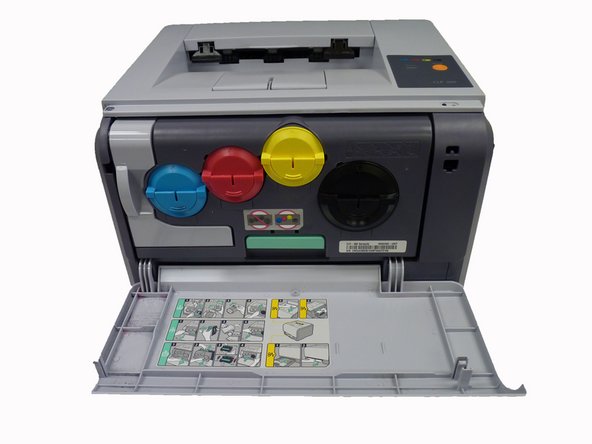

    • Turn the printer off and wait a few minutes for it to cool.
  2. Samsung CLP-300 Black Toner Transfer Unit Replacement: crwdns2935265:02crwdnd2935265:01crwdnd2935265:01crwdne2935265:0
    • Pull paper tray out and set aside.
  3. Samsung CLP-300 Black Toner Transfer Unit Replacement: crwdns2935265:03crwdnd2935265:01crwdnd2935265:02crwdne2935265:0 Samsung CLP-300 Black Toner Transfer Unit Replacement: crwdns2935265:03crwdnd2935265:02crwdnd2935265:02crwdne2935265:0
    • Open the front cover.
  4. Samsung CLP-300 Black Toner Transfer Unit Replacement: crwdns2935265:04crwdnd2935265:01crwdnd2935265:01crwdne2935265:0

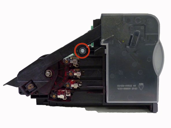

  6. Samsung CLP-300 Black Toner Transfer Unit Replacement: crwdns2935265:06crwdnd2935265:01crwdnd2935265:02crwdne2935265:0 Samsung CLP-300 Black Toner Transfer Unit Replacement: crwdns2935265:06crwdnd2935265:02crwdnd2935265:02crwdne2935265:0
    • Remove these two screws.
    • Do not expose imaging unit to light for more than a few minutes. Covering unit with a piece of paper is sufficient protection while you complete repair.

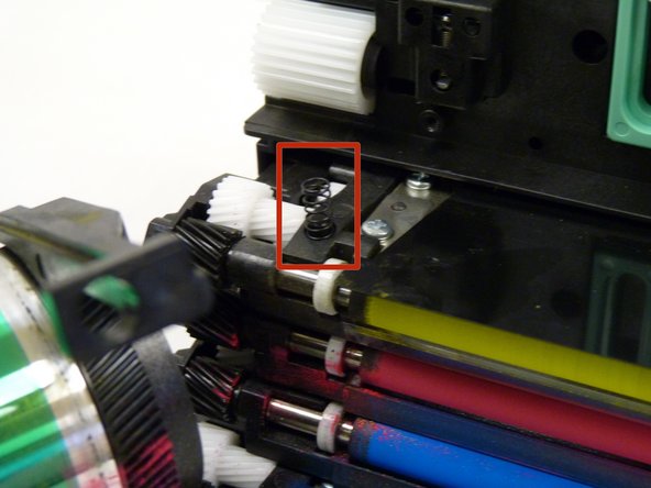

    • Carefully pry plastic from screw base so that the entire organic photo conductor piece slides open to the left.
    • When removing the organic photo conductor take care to not lose the small spring on the back left.
    • At this point you may want to put on plastic gloves to keep from staining hands with printer ink.

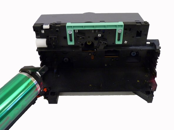

  9. Samsung CLP-300 Black Toner Transfer Unit Replacement: crwdns2935265:09crwdnd2935265:01crwdnd2935265:02crwdne2935265:0 Samsung CLP-300 Black Toner Transfer Unit Replacement: crwdns2935265:09crwdnd2935265:02crwdnd2935265:02crwdne2935265:0
    • Slide each toner transfer unit out separately, placing all aside except for the black toner transfer unit.
    • Keep toner rollers level to avoid toner spillage.

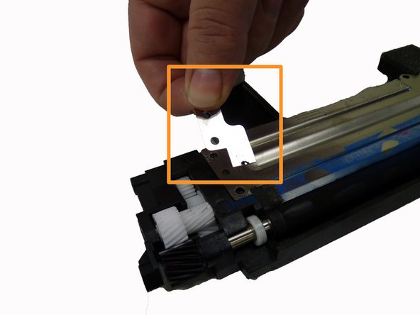

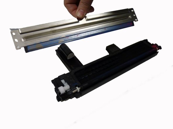

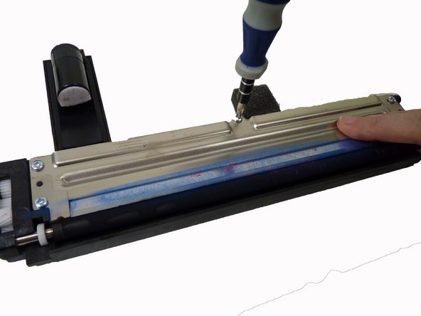

    • Remove these five screws from the top of the black toner transfer unit.
    • Remove main and smaller z-shaped plates.

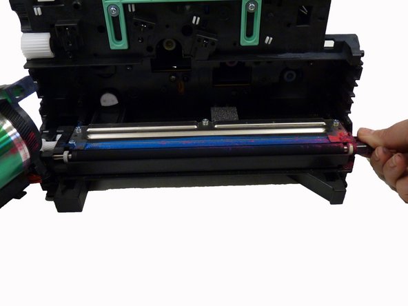

  12. Samsung CLP-300 Black Toner Transfer Unit Replacement: crwdns2935265:012crwdnd2935265:01crwdnd2935265:01crwdne2935265:0
    • Remove plastic end piece.
    • Gently pull out black toner roller.
    • Insert new roller in place of old roller turning slightly to fit.
    • Be careful not to pinch small foam square when inserting new roller.
    • Cover new roller with toner by rotating roller by hand.

I need more information for step 12: I removed the old roller. Unfortunately I don't know anymore how exactly the metal discs and the white plastic rings are placed.
