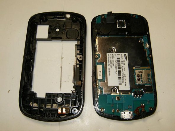

  2. Samsung Brightside Logic board Replacement: crwdns2935265:02crwdnd2935265:01crwdnd2935265:03crwdne2935265:0 Samsung Brightside Logic board Replacement: crwdns2935265:02crwdnd2935265:02crwdnd2935265:03crwdne2935265:0 Samsung Brightside Logic board Replacement: crwdns2935265:02crwdnd2935265:03crwdnd2935265:03crwdne2935265:0
    • Remove the battery
    • Remove the six Phillips screws from the back frame
    • All six screws are identical M1.5X3

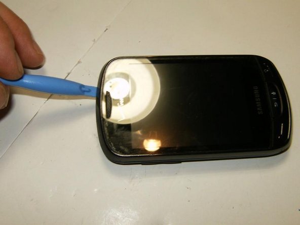

  3. Samsung Brightside Logic board Replacement: crwdns2935265:03crwdnd2935265:01crwdnd2935265:03crwdne2935265:0 Samsung Brightside Logic board Replacement: crwdns2935265:03crwdnd2935265:02crwdnd2935265:03crwdne2935265:0 Samsung Brightside Logic board Replacement: crwdns2935265:03crwdnd2935265:03crwdnd2935265:03crwdne2935265:0
    • Use a plastic opening tool or similar tool to separate the top from the bottom frame. Applying slight pressure in a downwards direction will disengage the plastic clips
    • Continue to slide the tool along the slot until you feel the plastic locks disengage
    • Once all locks have released, the bottom frame can simply be removed.

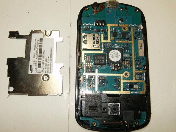

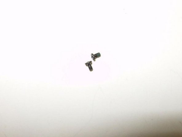

  4. Samsung Brightside Logic board Replacement: crwdns2935265:04crwdnd2935265:01crwdnd2935265:03crwdne2935265:0 Samsung Brightside Logic board Replacement: crwdns2935265:04crwdnd2935265:02crwdnd2935265:03crwdne2935265:0 Samsung Brightside Logic board Replacement: crwdns2935265:04crwdnd2935265:03crwdnd2935265:03crwdne2935265:0
    • Remove the two Phillips screws from the EMI shield.
    • Both screws are identical M1.5X2
    • Remove the EMI shield
  5. Samsung Brightside Logic board Replacement: crwdns2935265:05crwdnd2935265:01crwdnd2935265:02crwdne2935265:0 Samsung Brightside Logic board Replacement: crwdns2935265:05crwdnd2935265:02crwdnd2935265:02crwdne2935265:0

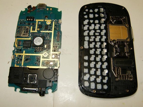

    • Detach the LCD connector.
    • Remove the logic board
