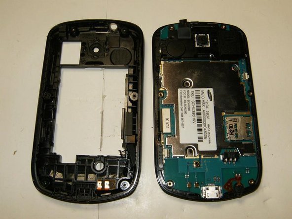

    • Here is the Samsung SCH-U380 Brightside.
    • Turn it over to gain access to the battery.
    • Remove the backcover by simply pulling it off the phone from the top down
  2. Samsung Brightside LCD Replacement: crwdns2935265:02crwdnd2935265:01crwdnd2935265:03crwdne2935265:0 Samsung Brightside LCD Replacement: crwdns2935265:02crwdnd2935265:02crwdnd2935265:03crwdne2935265:0 Samsung Brightside LCD Replacement: crwdns2935265:02crwdnd2935265:03crwdnd2935265:03crwdne2935265:0
    • Remove the battery
    • Remove the six Phillips screws from the back frame
    • All six screws are identical M1.5X3
  3. Samsung Brightside LCD Replacement: crwdns2935265:03crwdnd2935265:01crwdnd2935265:03crwdne2935265:0 Samsung Brightside LCD Replacement: crwdns2935265:03crwdnd2935265:02crwdnd2935265:03crwdne2935265:0 Samsung Brightside LCD Replacement: crwdns2935265:03crwdnd2935265:03crwdnd2935265:03crwdne2935265:0
    • Use a plastic opening tool or similar tool to separate the top from the bottom frame. Applying slight pressure in a downwards direction will disengage the plastic clips
    • Continue to slide the tool along the slot until you feel the plastic locks disengage
    • Once all locks have released, the bottom frame can simply be removed.

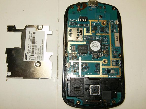

  4. Samsung Brightside LCD Replacement: crwdns2935265:04crwdnd2935265:01crwdnd2935265:03crwdne2935265:0 Samsung Brightside LCD Replacement: crwdns2935265:04crwdnd2935265:02crwdnd2935265:03crwdne2935265:0 Samsung Brightside LCD Replacement: crwdns2935265:04crwdnd2935265:03crwdnd2935265:03crwdne2935265:0

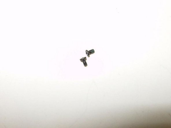

    • Remove the two Phillips screws from the EMI shield.
    • Both screws are identical M1.5X2
    • Remove the EMI shield

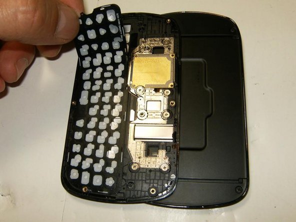

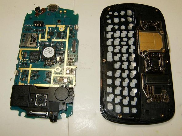

  5. Samsung Brightside LCD Replacement: crwdns2935265:05crwdnd2935265:01crwdnd2935265:03crwdne2935265:0 Samsung Brightside LCD Replacement: crwdns2935265:05crwdnd2935265:02crwdnd2935265:03crwdne2935265:0 Samsung Brightside LCD Replacement: crwdns2935265:05crwdnd2935265:03crwdnd2935265:03crwdne2935265:0

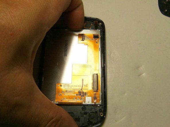

    • Detach the LCD connector.
    • Remove the logic board
    • Slide the front case assembly to the side, remove the keyboard membrane simply by lifting it out.

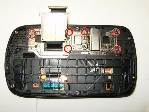

  6. Samsung Brightside LCD Replacement: crwdns2935265:06crwdnd2935265:01crwdnd2935265:03crwdne2935265:0 Samsung Brightside LCD Replacement: crwdns2935265:06crwdnd2935265:02crwdnd2935265:03crwdne2935265:0 Samsung Brightside LCD Replacement: crwdns2935265:06crwdnd2935265:03crwdnd2935265:03crwdne2935265:0
    • Remove the flex cable from the assembly. It is adhered with some rubber cement and may require a bit of pull
    • move the flex to the side
    • Remove the six Phillips screws from the assembly

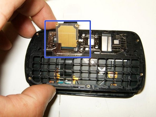

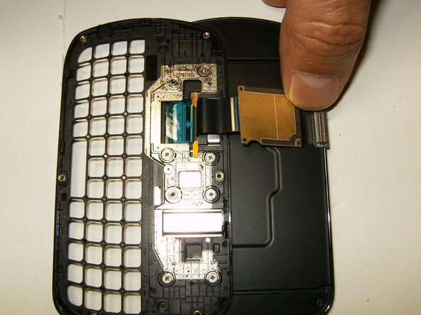

  7. Samsung Brightside LCD Replacement: crwdns2935265:07crwdnd2935265:01crwdnd2935265:03crwdne2935265:0 Samsung Brightside LCD Replacement: crwdns2935265:07crwdnd2935265:02crwdnd2935265:03crwdne2935265:0 Samsung Brightside LCD Replacement: crwdns2935265:07crwdnd2935265:03crwdnd2935265:03crwdne2935265:0
    • All six screws are M1x1
    • The assembly is now loose and can be gently lifted up.
    • Carefully guide the flex cable through the assembly. It only fits one way.

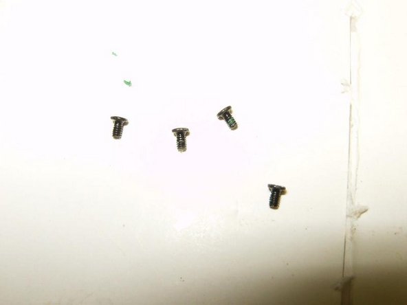

  8. Samsung Brightside LCD Replacement: crwdns2935265:08crwdnd2935265:01crwdnd2935265:03crwdne2935265:0 Samsung Brightside LCD Replacement: crwdns2935265:08crwdnd2935265:02crwdnd2935265:03crwdne2935265:0 Samsung Brightside LCD Replacement: crwdns2935265:08crwdnd2935265:03crwdnd2935265:03crwdne2935265:0
    • Remove the four Phillips screws from the slider case
    • All four screws are identical M1x2
    • Here are all screws removed.

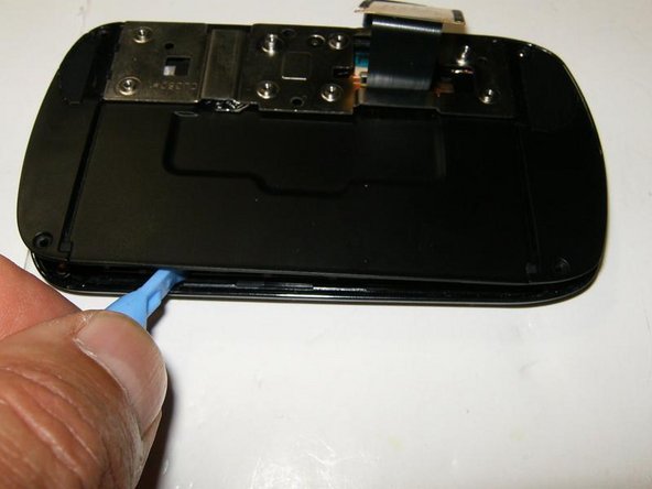

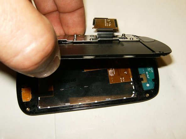

  9. Samsung Brightside LCD Replacement: crwdns2935265:09crwdnd2935265:01crwdnd2935265:03crwdne2935265:0 Samsung Brightside LCD Replacement: crwdns2935265:09crwdnd2935265:02crwdnd2935265:03crwdne2935265:0 Samsung Brightside LCD Replacement: crwdns2935265:09crwdnd2935265:03crwdnd2935265:03crwdne2935265:0
    • Insert a plastic opening tool, or similar, to separate the sliding assembly from the case
    • Guide the opening tool all the way around the slider. This will release the clips that hold it in place.
    • With the clips released, the sliding mechanism can be lifted up, careful to not rip the flex

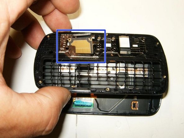

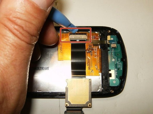

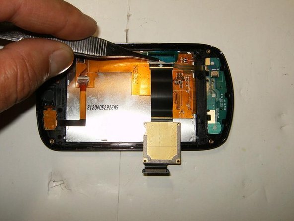

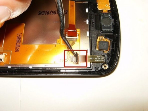

  10. Samsung Brightside LCD Replacement: crwdns2935265:010crwdnd2935265:01crwdnd2935265:03crwdne2935265:0 Samsung Brightside LCD Replacement: crwdns2935265:010crwdnd2935265:02crwdnd2935265:03crwdne2935265:0 Samsung Brightside LCD Replacement: crwdns2935265:010crwdnd2935265:03crwdnd2935265:03crwdne2935265:0
    • Guide the flex through the sliding mechanism while lifting it up
    • Remove the Kapton tape
    • Release the connector for the flex by simply opening it upward.
    • This is an L-shaped flex and requires two connectors to be released.
  11. Samsung Brightside LCD Replacement: crwdns2935265:011crwdnd2935265:01crwdnd2935265:03crwdne2935265:0 Samsung Brightside LCD Replacement: crwdns2935265:011crwdnd2935265:02crwdnd2935265:03crwdne2935265:0 Samsung Brightside LCD Replacement: crwdns2935265:011crwdnd2935265:03crwdnd2935265:03crwdne2935265:0
    • Release the L-shaped flex from the button bar as well
    • Removing the button bar is not necessary, but it will be loose and will fall out anyway.

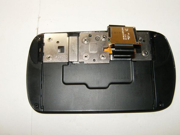

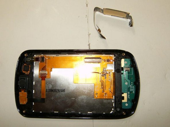

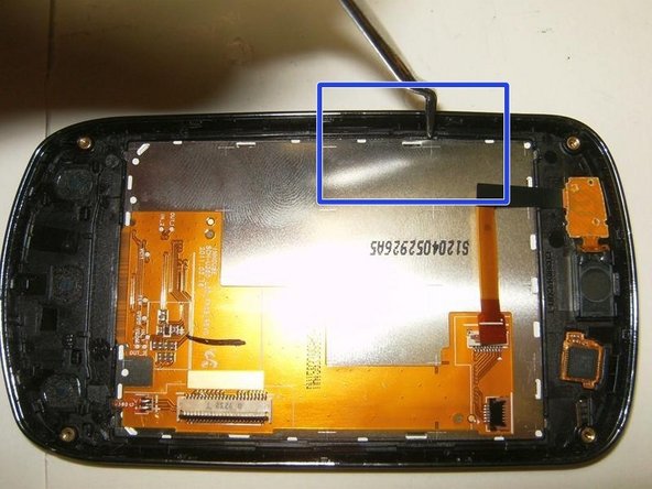

  12. Samsung Brightside LCD Replacement: crwdns2935265:012crwdnd2935265:01crwdnd2935265:03crwdne2935265:0 Samsung Brightside LCD Replacement: crwdns2935265:012crwdnd2935265:02crwdnd2935265:03crwdne2935265:0 Samsung Brightside LCD Replacement: crwdns2935265:012crwdnd2935265:03crwdnd2935265:03crwdne2935265:0
    • Remove the proximity sensor/front speaker flex
    • Remove the digitizer flex

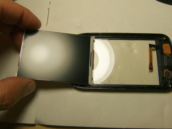

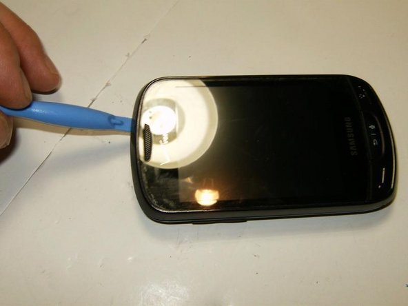

    • The LCD is glued to the front case. Use a pick or similar to release the LCD.
  13. Samsung Brightside LCD Replacement: crwdns2935265:013crwdnd2935265:01crwdnd2935265:03crwdne2935265:0 Samsung Brightside LCD Replacement: crwdns2935265:013crwdnd2935265:02crwdnd2935265:03crwdne2935265:0 Samsung Brightside LCD Replacement: crwdns2935265:013crwdnd2935265:03crwdnd2935265:03crwdne2935265:0
    • Move the pick, or similar all the way around the LCD to release the adhesive. A gentle prying may be necessary.
    • Once the adhesive is loosened, use your fingernails, or similar, to remove the LCD from the case.
    • Fold the LCD to the bottom of the frame.

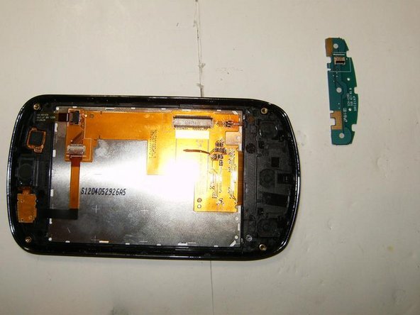

  14. Samsung Brightside LCD Replacement: crwdns2935265:014crwdnd2935265:01crwdnd2935265:01crwdne2935265:0
    • Here is the LCD removed. LCD and Digitizer are separate piece which makes the a economical feasible repair.
