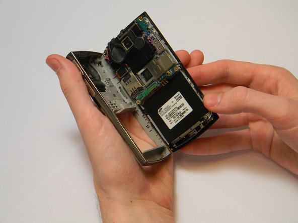

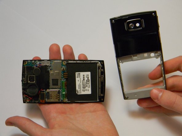

  5. Samsung BlackJack II Front Casing Replacement: crwdns2935265:05crwdnd2935265:01crwdnd2935265:03crwdne2935265:0 Samsung BlackJack II Front Casing Replacement: crwdns2935265:05crwdnd2935265:02crwdnd2935265:03crwdne2935265:0 Samsung BlackJack II Front Casing Replacement: crwdns2935265:05crwdnd2935265:03crwdnd2935265:03crwdne2935265:0
    • Insert the plastic opening tool in the gap between the back panel and rest of the body.
    • Slide the tool along the edges until the two pieces come apart.
    • The circuit board is attached to the front casing. Both casings should separate without having to sever electrical connections.

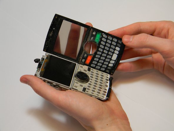

  6. Samsung BlackJack II Front Casing Replacement, Front Casing: crwdns2935265:06crwdnd2935265:01crwdnd2935265:02crwdne2935265:0 Samsung BlackJack II Front Casing Replacement, Front Casing: crwdns2935265:06crwdnd2935265:02crwdnd2935265:02crwdne2935265:0
    • Pry apart the plastic tabs along the edges of the phone.
    • Separate the front panel from the main body of the phone using your fingers.
