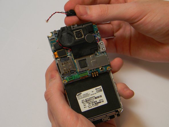

  7. Samsung BlackJack II Audio Receiver Replacement, Audio Receiver: crwdns2935265:07crwdnd2935265:01crwdnd2935265:01crwdne2935265:0
    • The audio receiver is a small rectangular piece connected via wire to the circuit board.
    • Carefully free the audio receiver so it is only connected by a small, clear plug on the circuit board.
  8. Samsung BlackJack II Audio Receiver Replacement: crwdns2935265:08crwdnd2935265:01crwdnd2935265:02crwdne2935265:0 Samsung BlackJack II Audio Receiver Replacement: crwdns2935265:08crwdnd2935265:02crwdnd2935265:02crwdne2935265:0
    • Use the spudger to separate the clear plug from its connector on the circuit board.
    • Use light force to avoid damaging any fragile components.
