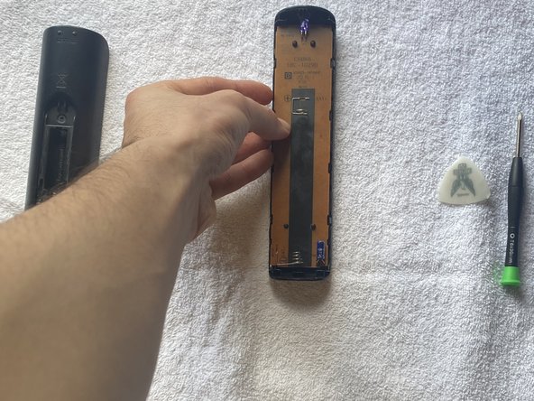

    • Remove the batteries before you disassemble the remote.
    • Use an opening pick in the seam of the controller and work it around the perimeter.
    • With the opening pick, scrape and remove the glue and undo the clips holding the top and bottom of the remote together.
  2. Samsung BN59-01199F Keypad Replacement: crwdns2935265:02crwdnd2935265:01crwdnd2935265:02crwdne2935265:0 Samsung BN59-01199F Keypad Replacement: crwdns2935265:02crwdnd2935265:02crwdnd2935265:02crwdne2935265:0
    • Use additional opening picks to keep the seam open.
    • Don't use a screwdriver or metal spudger for prying especially because the motherboard is directly underneath and could be damaged in the process.
    • Use a spudger or opening pick to work your way around the seam of the remote.
    • Separate the two sides of the remote.
  3. Samsung BN59-01199F Keypad Replacement: crwdns2935265:03crwdnd2935265:01crwdnd2935265:03crwdne2935265:0 Samsung BN59-01199F Keypad Replacement: crwdns2935265:03crwdnd2935265:02crwdnd2935265:03crwdne2935265:0 Samsung BN59-01199F Keypad Replacement: crwdns2935265:03crwdnd2935265:03crwdnd2935265:03crwdne2935265:0
    • Remove the motherboard, the plastic button case, and finally the buttons from the plastic case.
    • Place the new keypad into the keypad holder and press to make sure it's set in securely.
  4. Samsung BN59-01199F Keypad Replacement: crwdns2935265:04crwdnd2935265:01crwdnd2935265:02crwdne2935265:0 Samsung BN59-01199F Keypad Replacement: crwdns2935265:04crwdnd2935265:02crwdnd2935265:02crwdne2935265:0
    • After replacing the rubber keypad, reassemble the remote.
    • Make sure to insert the light in the small hole during reassembly.
  5. Samsung BN59-01199F Keypad Replacement: crwdns2935265:05crwdnd2935265:01crwdnd2935265:03crwdne2935265:0 Samsung BN59-01199F Keypad Replacement: crwdns2935265:05crwdnd2935265:02crwdnd2935265:03crwdne2935265:0 Samsung BN59-01199F Keypad Replacement: crwdns2935265:05crwdnd2935265:03crwdnd2935265:03crwdne2935265:0
    • When joining the two halves of the remote together line the spring up with the appropriate slot.
    • Carefully, press the two parts of the remote together.
  6. Samsung BN59-01199F Keypad Replacement: crwdns2935265:06crwdnd2935265:01crwdnd2935265:01crwdne2935265:0
    • Make sure the remote is working after you put it back together and replaced the batteries.
