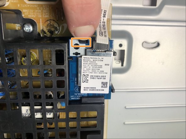

  4. Samsung BD-JM57C Power Cord Replacement, WiFi Card: crwdns2935265:04crwdnd2935265:01crwdnd2935265:02crwdne2935265:0 Samsung BD-JM57C Power Cord Replacement, WiFi Card: crwdns2935265:04crwdnd2935265:02crwdnd2935265:02crwdne2935265:0
    • Pull clip to remove the WiFi card ribbon connected to the circuit board.
    • Push the black plastic tab out and slide the WiFi card out from the cage.
