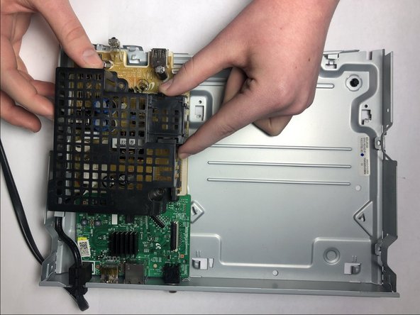

  4. Samsung BD-JM57C Motherboard Replacement, Power Cord: crwdns2935265:04crwdnd2935265:01crwdnd2935265:02crwdne2935265:0 Samsung BD-JM57C Motherboard Replacement, Power Cord: crwdns2935265:04crwdnd2935265:02crwdnd2935265:02crwdne2935265:0
    • Use the Phillips #00 Screwdriver to remove the two 6.4 mm screws holding the cage in place.
    • Lift the cage up to remove it.
