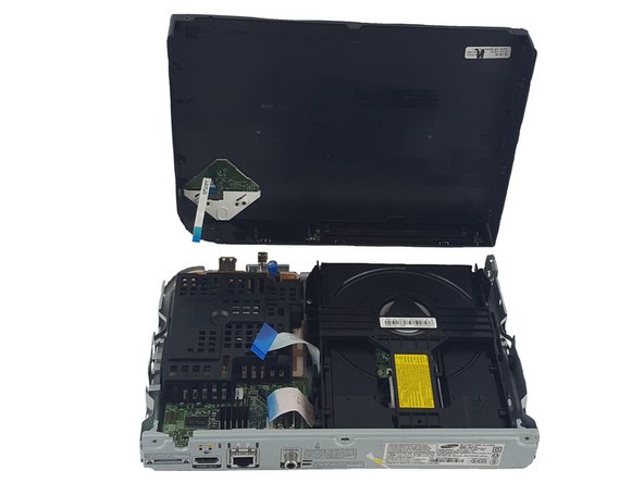

    • Use the plastic spudger to pry open the top panel.
    • Be careful not to break the ribbon connecting the motherboard on the bottom panel to the top panel.
  3. Samsung BD-H5100 Power Cord Replacement: crwdns2935265:03crwdnd2935265:01crwdnd2935265:02crwdne2935265:0 Samsung BD-H5100 Power Cord Replacement: crwdns2935265:03crwdnd2935265:02crwdnd2935265:02crwdne2935265:0
    • Pull the ribbons gently from one corner by the blue tabs to remove it.

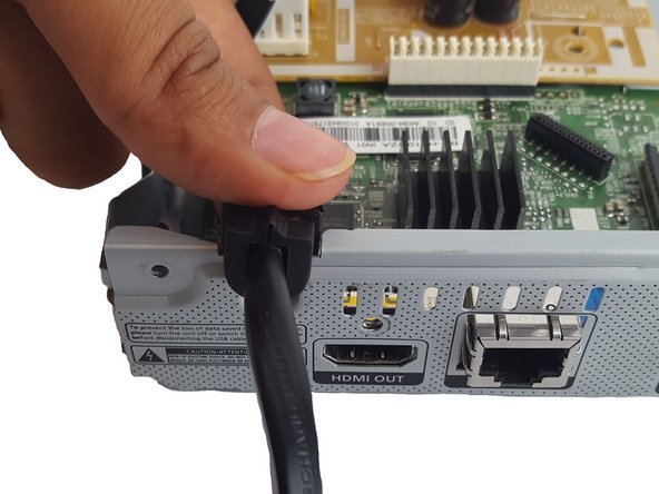

    • Use a Phillips Head #2 to remove the two 7.5mm screws on the black cover.
  5. Samsung BD-H5100 Power Cord Replacement: crwdns2935265:05crwdnd2935265:01crwdnd2935265:01crwdne2935265:0
    • Remove the black cover.
  6. Samsung BD-H5100 Power Cord Replacement: crwdns2935265:06crwdnd2935265:01crwdnd2935265:02crwdne2935265:0 Samsung BD-H5100 Power Cord Replacement: crwdns2935265:06crwdnd2935265:02crwdnd2935265:02crwdne2935265:0
    • Pinch the white clip and pull straight up on the power cord.
    • Remove power cord.
