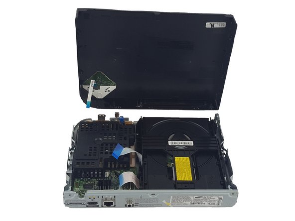

    • Use the Phillips Head #2 screwdriver to remove the three 10mm screws on the back panel.
  2. Samsung BD-H5100 Media Controls Replacement: crwdns2935265:02crwdnd2935265:01crwdnd2935265:03crwdne2935265:0 Samsung BD-H5100 Media Controls Replacement: crwdns2935265:02crwdnd2935265:02crwdnd2935265:03crwdne2935265:0 Samsung BD-H5100 Media Controls Replacement: crwdns2935265:02crwdnd2935265:03crwdnd2935265:03crwdne2935265:0
    • Use the plastic spudger to pry open the top panel from the center tab.
    • Be careful not to break the ribbon connecting the motherboard on the bottom panel to the top panel.
  3. Samsung BD-H5100 Media Controls Replacement: crwdns2935265:03crwdnd2935265:01crwdnd2935265:02crwdne2935265:0 Samsung BD-H5100 Media Controls Replacement: crwdns2935265:03crwdnd2935265:02crwdnd2935265:02crwdne2935265:0
    • Pull the ribbon gently from one corner by the blue tab to remove it.
  4. Samsung BD-H5100 Media Controls Replacement: crwdns2935265:04crwdnd2935265:01crwdnd2935265:01crwdne2935265:0
    • Use a Phillips Head #00 to unscrew the two 7mm screws on the media controls.
  5. Samsung BD-H5100 Media Controls Replacement: crwdns2935265:05crwdnd2935265:01crwdnd2935265:01crwdne2935265:0
    • Remove the white cover from the media controls.
