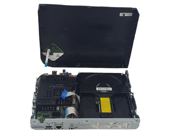

    • Use the plastic spudger to pry open the top panel.
    • Be careful not to break the ribbon connecting the motherboard on the bottom panel to the top panel.
  3. Samsung BD-H5100 Disk Reader Replacement: crwdns2935265:03crwdnd2935265:01crwdnd2935265:02crwdne2935265:0 Samsung BD-H5100 Disk Reader Replacement: crwdns2935265:03crwdnd2935265:02crwdnd2935265:02crwdne2935265:0
    • Pull the ribbons gently from one corner by the blue tabs to remove it.

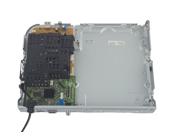

    • Push two small prongs on both sides inwards and push forward.
    • Remove the disk tray.
