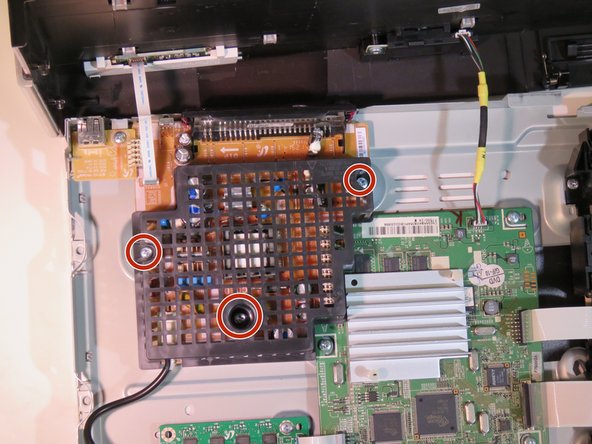

  3. Samsung BD-F7500 Blu-ray Player Power Cord Replacement: crwdns2935265:03crwdnd2935265:01crwdnd2935265:03crwdne2935265:0 Samsung BD-F7500 Blu-ray Player Power Cord Replacement: crwdns2935265:03crwdnd2935265:02crwdnd2935265:03crwdne2935265:0 Samsung BD-F7500 Blu-ray Player Power Cord Replacement: crwdns2935265:03crwdnd2935265:03crwdnd2935265:03crwdne2935265:0
    • Using the Philips head #J1 bit, remove the three (3) 10 mm screws that secure the plastic cover.
    • Gently remove the plastic cover.

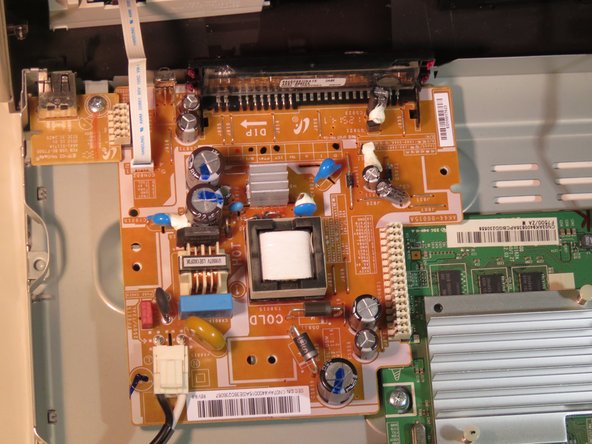

  4. Samsung BD-F7500 Blu-ray Player Power Cord Replacement: crwdns2935265:04crwdnd2935265:01crwdnd2935265:02crwdne2935265:0 Samsung BD-F7500 Blu-ray Player Power Cord Replacement: crwdns2935265:04crwdnd2935265:02crwdnd2935265:02crwdne2935265:0

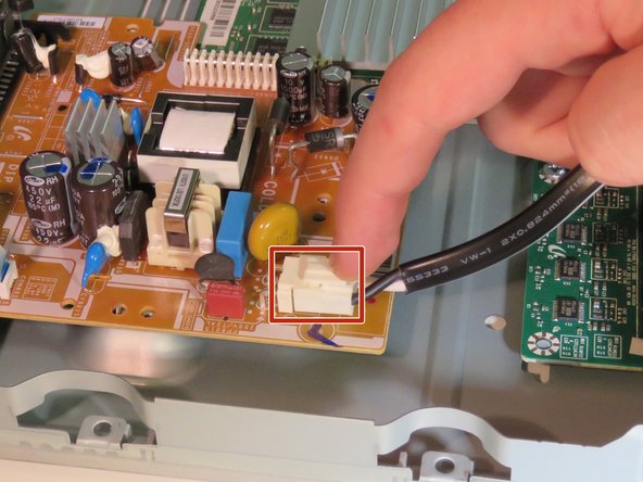

    • To remove the power cord, gently apply pressure to the tab located at the base of the cord and lift the cord with your fingers.
  5. Samsung BD-F7500 Blu-ray Player Power Cord Replacement: crwdns2935265:05crwdnd2935265:01crwdnd2935265:01crwdne2935265:0
    • Locate the black plastic tab located on the power cord.
    • Using a spudger, gently insert the tool into the crack, to allow space for the wire to slide out.
    • Pull the plastic tab off of the wire, so that it can be placed on the replacement power cord.
