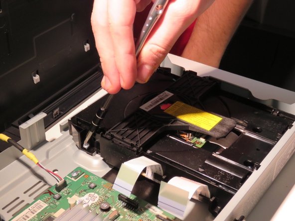

    • Use a Phillips head #J1 screwdriver to remove all three (3) 10 mm screws.
  2. Samsung BD-F7500 Blu-ray Player Disc Tray Replacement: crwdns2935265:02crwdnd2935265:01crwdnd2935265:03crwdne2935265:0 Samsung BD-F7500 Blu-ray Player Disc Tray Replacement: crwdns2935265:02crwdnd2935265:02crwdnd2935265:03crwdne2935265:0 Samsung BD-F7500 Blu-ray Player Disc Tray Replacement: crwdns2935265:02crwdnd2935265:03crwdnd2935265:03crwdne2935265:0
    • To remove each ribbon cable, firmly grip the hard plastic tab attached to the base and pull upwards.
    • Be careful not to tear the ribbon cables.
  3. Samsung BD-F7500 Blu-ray Player Disc Tray Replacement: crwdns2935265:03crwdnd2935265:01crwdnd2935265:03crwdne2935265:0 Samsung BD-F7500 Blu-ray Player Disc Tray Replacement: crwdns2935265:03crwdnd2935265:02crwdnd2935265:03crwdne2935265:0 Samsung BD-F7500 Blu-ray Player Disc Tray Replacement: crwdns2935265:03crwdnd2935265:03crwdnd2935265:03crwdne2935265:0
    • Using a screwdriver with a #J1 bit, remove the two (2) 7 mm screws.

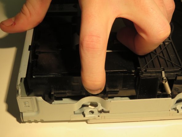

  4. Samsung BD-F7500 Blu-ray Player Disc Tray Replacement: crwdns2935265:04crwdnd2935265:01crwdnd2935265:03crwdne2935265:0 Samsung BD-F7500 Blu-ray Player Disc Tray Replacement: crwdns2935265:04crwdnd2935265:02crwdnd2935265:03crwdne2935265:0 Samsung BD-F7500 Blu-ray Player Disc Tray Replacement: crwdns2935265:04crwdnd2935265:03crwdnd2935265:03crwdne2935265:0
    • Locate the two black tabs on each side of the disc tray. The second tab is located in the same location on opposite side of marked tab.
    • While pinching both tabs, slightly push the disc tray towards the front of the device, and lift the disc tray out.
