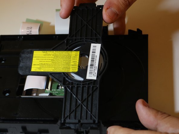

  4. Samsung BD-F7500 Blu-ray Player Disc Reader Replacement: crwdns2935265:04crwdnd2935265:01crwdnd2935265:03crwdne2935265:0 Samsung BD-F7500 Blu-ray Player Disc Reader Replacement: crwdns2935265:04crwdnd2935265:02crwdnd2935265:03crwdne2935265:0 Samsung BD-F7500 Blu-ray Player Disc Reader Replacement: crwdns2935265:04crwdnd2935265:03crwdnd2935265:03crwdne2935265:0
    • Locate the two black tabs on each side of the disc tray. The second tab is located in the same location on opposite side of marked tab.
    • While pinching both tabs, slightly push the disc tray towards the front of the device, and lift the disc tray out.

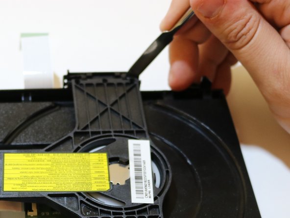

  6. Samsung BD-F7500 Blu-ray Player Disc Reader Replacement: crwdns2935265:06crwdnd2935265:01crwdnd2935265:03crwdne2935265:0 Samsung BD-F7500 Blu-ray Player Disc Reader Replacement: crwdns2935265:06crwdnd2935265:02crwdnd2935265:03crwdne2935265:0 Samsung BD-F7500 Blu-ray Player Disc Reader Replacement: crwdns2935265:06crwdnd2935265:03crwdnd2935265:03crwdne2935265:0
    • Locate the two black tabs, found at the end of the black bar across the disc tray. The tabs are located on the opposite side of the spring.
    • While simultaneously pushing both tabs in, lift up the black plastic bar.
    • Using a spudger, it is helpful to push in the tab as well as using the spudger as a lever.
    • The tabs are weak, constant pressure is the key, not overpowering force.

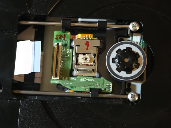

  9. Samsung BD-F7500 Blu-ray Player Disc Reader Replacement: crwdns2935265:09crwdnd2935265:01crwdnd2935265:02crwdne2935265:0 Samsung BD-F7500 Blu-ray Player Disc Reader Replacement: crwdns2935265:09crwdnd2935265:02crwdnd2935265:02crwdne2935265:0
    • Flip the disc tray over so the laser points downward.
    • Pull the disc reader out of the disc tray.
    • The laser may need to be turned on its side as its pulled out.
