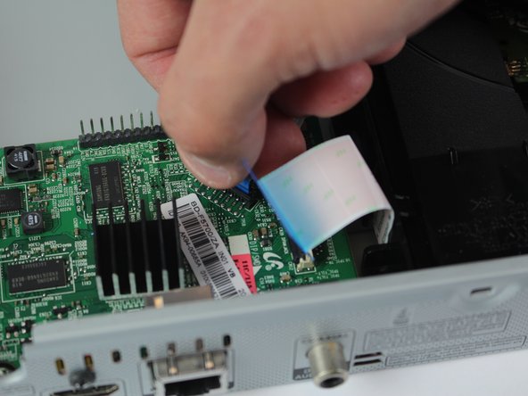

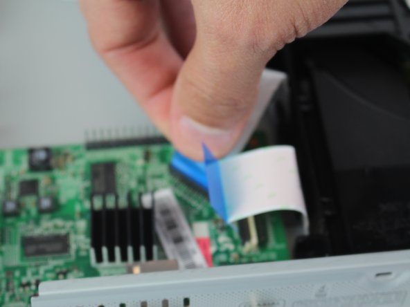

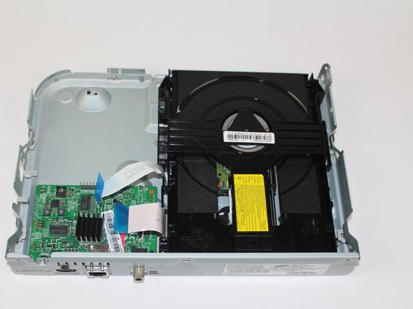

    • Use Phillips 0 Screwdriver to remove two (2), 10 mm rear screws.
    • Use the iFixit opening tool to help separate the top plastic casing from the bottom metal casing.
    • When opening the device, be careful to not damage the ribbon cable circled in image 3.

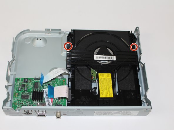

  2. Samsung BD-F5700 Disc Reader Replacement: crwdns2935265:02crwdnd2935265:01crwdnd2935265:03crwdne2935265:0 Samsung BD-F5700 Disc Reader Replacement: crwdns2935265:02crwdnd2935265:02crwdnd2935265:03crwdne2935265:0 Samsung BD-F5700 Disc Reader Replacement: crwdns2935265:02crwdnd2935265:03crwdnd2935265:03crwdne2935265:0
    • Use Phillips 0 screwdriver to remove two (2), 10 mm screws from the plastic cover.
    • Remove plastic cover from board.

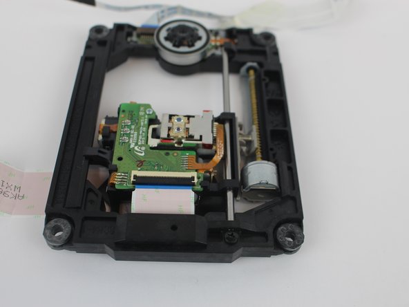

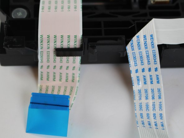

  5. Samsung BD-F5700 Disc Reader Replacement, Disc Reader: crwdns2935265:05crwdnd2935265:01crwdnd2935265:03crwdne2935265:0 Samsung BD-F5700 Disc Reader Replacement, Disc Reader: crwdns2935265:05crwdnd2935265:02crwdnd2935265:03crwdne2935265:0 Samsung BD-F5700 Disc Reader Replacement, Disc Reader: crwdns2935265:05crwdnd2935265:03crwdnd2935265:03crwdne2935265:0
    • Firmly grip the hard plastic tab attached to the base and pull upwards.
    • It is important to not tear the ribbon cables.

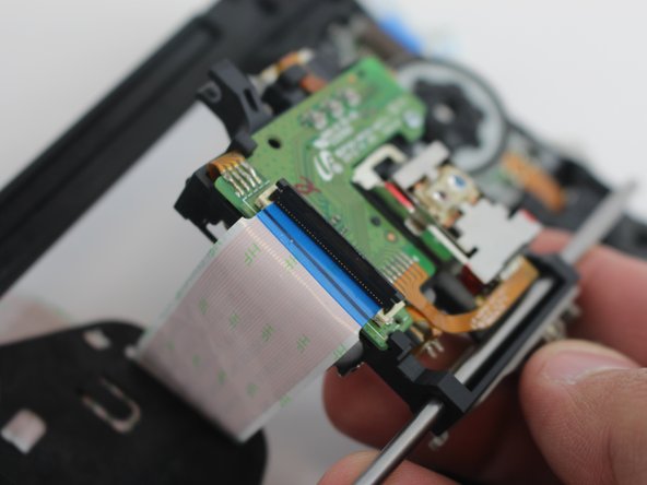

  8. Samsung BD-F5700 Disc Reader Replacement: crwdns2935265:08crwdnd2935265:01crwdnd2935265:03crwdne2935265:0 Samsung BD-F5700 Disc Reader Replacement: crwdns2935265:08crwdnd2935265:02crwdnd2935265:03crwdne2935265:0 Samsung BD-F5700 Disc Reader Replacement: crwdns2935265:08crwdnd2935265:03crwdnd2935265:03crwdne2935265:0
    • Flip up the black locking tab on the ZIF connector.

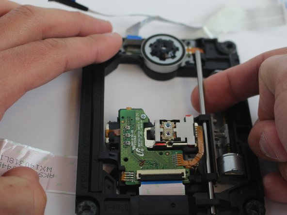

  9. Samsung BD-F5700 Disc Reader Replacement: crwdns2935265:09crwdnd2935265:01crwdnd2935265:03crwdne2935265:0 Samsung BD-F5700 Disc Reader Replacement: crwdns2935265:09crwdnd2935265:02crwdnd2935265:03crwdne2935265:0 Samsung BD-F5700 Disc Reader Replacement: crwdns2935265:09crwdnd2935265:03crwdnd2935265:03crwdne2935265:0
    • Remove the 10 mm screw using a Phillips #1 screwdriver.
    • Remove the small metal bar by pulling it outwards.

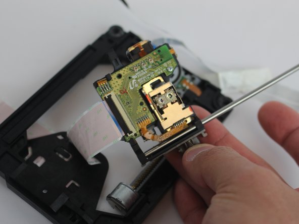

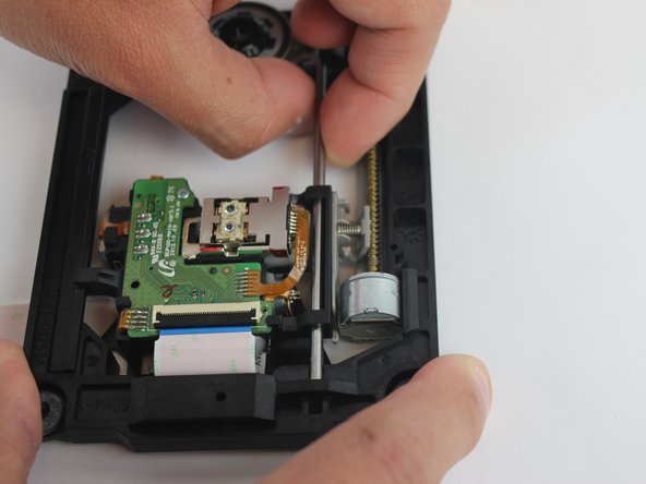

  10. Samsung BD-F5700 Disc Reader Replacement: crwdns2935265:010crwdnd2935265:01crwdnd2935265:02crwdne2935265:0 Samsung BD-F5700 Disc Reader Replacement: crwdns2935265:010crwdnd2935265:02crwdnd2935265:02crwdne2935265:0
    • Flip the disc tray over so the laser points downward.
    • Pull the disc reader out of the disc tray.
