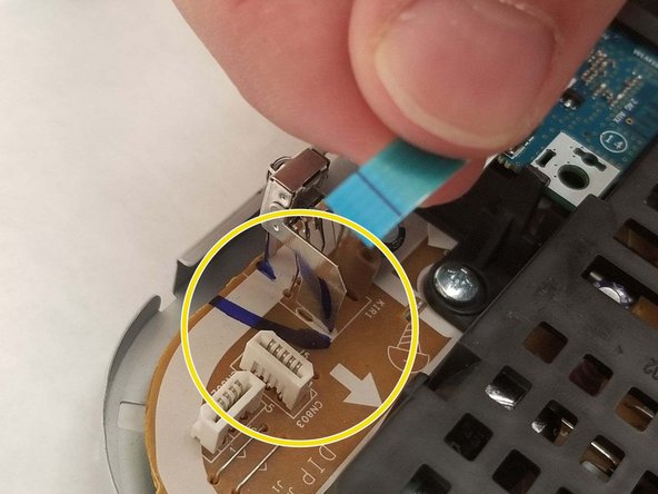

    • Remove the two 10mm Phillips #1 screws.
    • Remove the one 8 mm Phillips #1 screw.
    • Carefully lift up the cover and lay back, to ensure that you do not damage the attached cable.
  2. Samsung BD-E5400 Wi-Fi Card Replacement: crwdns2935265:02crwdnd2935265:01crwdnd2935265:01crwdne2935265:0
    • Unplug the small wiring bundle attaching the body of the device to the cover.
    • Lay the cover aside.

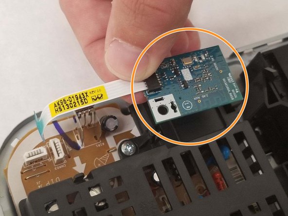

  3. Samsung BD-E5400 Wi-Fi Card Replacement, WIFI Card: crwdns2935265:03crwdnd2935265:01crwdnd2935265:03crwdne2935265:0 Samsung BD-E5400 Wi-Fi Card Replacement, WIFI Card: crwdns2935265:03crwdnd2935265:02crwdnd2935265:03crwdne2935265:0 Samsung BD-E5400 Wi-Fi Card Replacement, WIFI Card: crwdns2935265:03crwdnd2935265:03crwdnd2935265:03crwdne2935265:0
    • The Wi-Fi card is the light blue component circled in red.
    • Separate the body of the Wi-Fi card from the black plastic cover.
    • Unplug the wires of the Wi-Fi card from the motherboard.

I replaced my wifi card now none of the apps are working. I tried factory reset, and updating firmware nothing. Any ideas to get past this?
