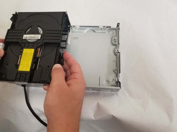

  2. Samsung BD-E5400 Disk Drive Replacement: crwdns2935265:02crwdnd2935265:01crwdnd2935265:01crwdne2935265:0
    • Unplug the small wiring bundle attaching the body of the device to the cover.
    • Lay the cover aside.

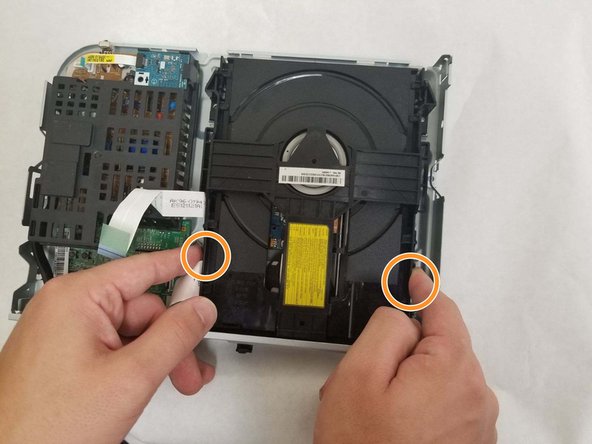

  3. Samsung BD-E5400 Disk Drive Replacement, Disk Drive: crwdns2935265:03crwdnd2935265:01crwdnd2935265:02crwdne2935265:0 Samsung BD-E5400 Disk Drive Replacement, Disk Drive: crwdns2935265:03crwdnd2935265:02crwdnd2935265:02crwdne2935265:0
    • Remove both wire bundles from motherboard.
    • Depress tabs located on each side of disk drive as shown.
  4. Samsung BD-E5400 Disk Drive Replacement: crwdns2935265:04crwdnd2935265:01crwdnd2935265:01crwdne2935265:0
    • Push entire disk drive forward.
    • Remove disk drive and replace.
