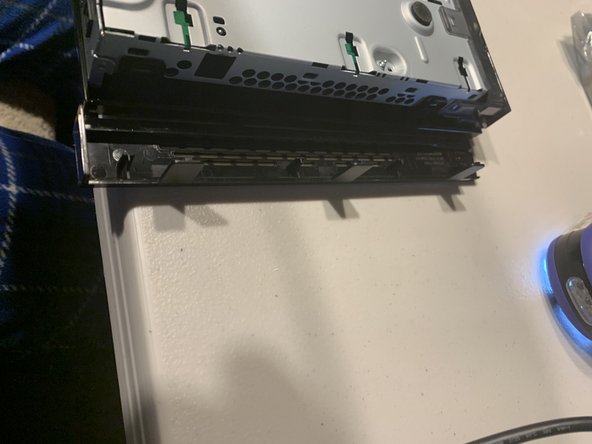

    • Start by turning the device over.
    • On each side there are three black tabs that hold each side cover on.
    • Carefully pry up on each one with a flat head screwdriver (or similar) and each side cover should pop right off.
    • Set side covers aside.
