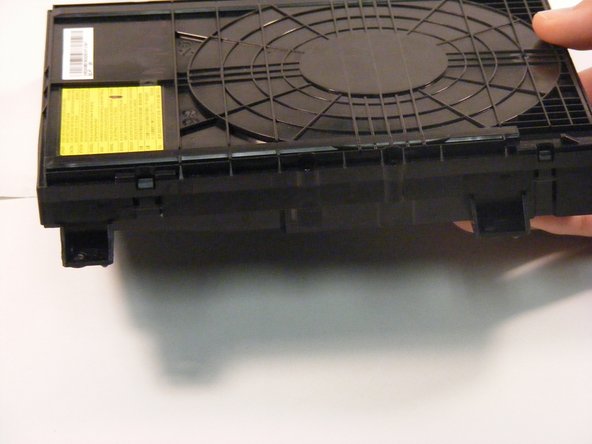

    • Once you have removed the four screws using a Phillips #2 screwdriver you are now able to take out the disc drive
    • Carefully remove the disc drive being sure not to disrupt anything else in the Blu-Ray player.
    • This is how your disc drive should look if you have removed it from the player correctly.
