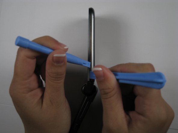

    2. Samsung Alias 2 Speaker Replacement: crwdns2935265:04crwdnd2935265:01crwdnd2935265:02crwdne2935265:0 Samsung Alias 2 Speaker Replacement: crwdns2935265:04crwdnd2935265:02crwdnd2935265:02crwdne2935265:0
      • Remove the upper casing with a plastic opening tools.

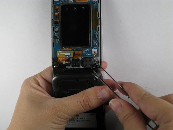

    4. Samsung Alias 2 Speaker Replacement: crwdns2935265:06crwdnd2935265:01crwdnd2935265:02crwdne2935265:0 Samsung Alias 2 Speaker Replacement: crwdns2935265:06crwdnd2935265:02crwdnd2935265:02crwdne2935265:0
      • Use tweezers to remove the speaker from its place.
      • Note: There are two speakers. Make sure you know which one is broken before removing it.
    5. Samsung Alias 2 Speaker Replacement: crwdns2935265:07crwdnd2935265:01crwdnd2935265:02crwdne2935265:0 Samsung Alias 2 Speaker Replacement: crwdns2935265:07crwdnd2935265:02crwdnd2935265:02crwdne2935265:0
      • Use tweezers to insert the new speaker into the speaker slot.
    6. Samsung Alias 2 Speaker Replacement: crwdns2935265:08crwdnd2935265:01crwdnd2935265:01crwdne2935265:0
      • Solder a speaker ribbon to the logic board.
      • Note: be careful to match the right polarity before you solder.
