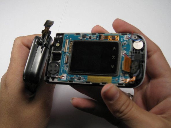

  7. Samsung Alias 2 Hinge Replacement: crwdns2935265:07crwdnd2935265:01crwdnd2935265:02crwdne2935265:0 Samsung Alias 2 Hinge Replacement: crwdns2935265:07crwdnd2935265:02crwdnd2935265:02crwdne2935265:0
    • Pull the two halves of the phone apart.
    • The phone will not slide straight apart. You have to angle the back half up a little.
    • Do not force it. Jiggle it a little if it doesn't come apart.

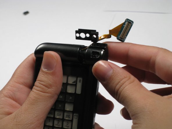

    • Remove the plastic panel cover from the hinge.
  9. Samsung Alias 2 Hinge Replacement: crwdns2935265:09crwdnd2935265:01crwdnd2935265:02crwdne2935265:0 Samsung Alias 2 Hinge Replacement: crwdns2935265:09crwdnd2935265:02crwdnd2935265:02crwdne2935265:0
    • Remove the 3.41 mm screw out from underneath plastic cover.

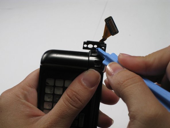

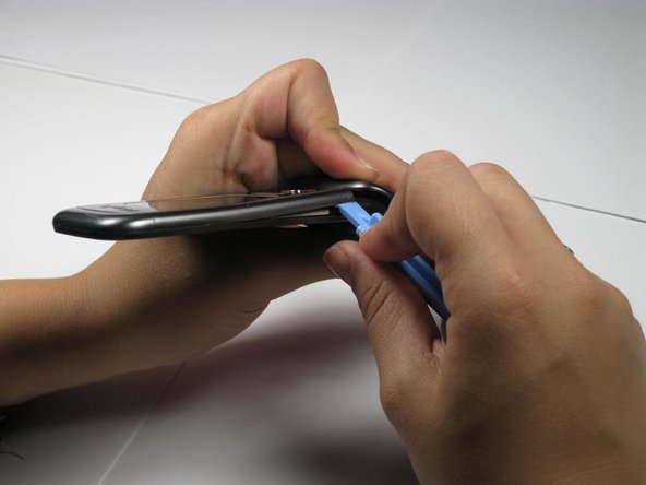

  10. Samsung Alias 2 Hinge Replacement: crwdns2935265:010crwdnd2935265:01crwdnd2935265:02crwdne2935265:0 Samsung Alias 2 Hinge Replacement: crwdns2935265:010crwdnd2935265:02crwdnd2935265:02crwdne2935265:0
    • Pop out the top half of the hinge with the plastic opening tool. This will release the hinge cover for removal.
  11. Samsung Alias 2 Hinge Replacement: crwdns2935265:011crwdnd2935265:01crwdnd2935265:02crwdne2935265:0 Samsung Alias 2 Hinge Replacement: crwdns2935265:011crwdnd2935265:02crwdnd2935265:02crwdne2935265:0
    • Pull off the hinge cover.

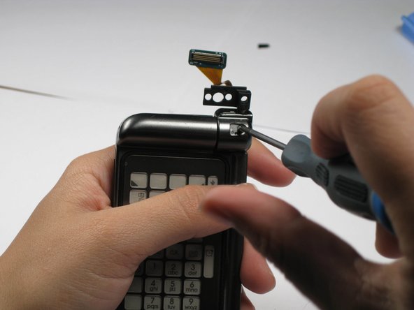

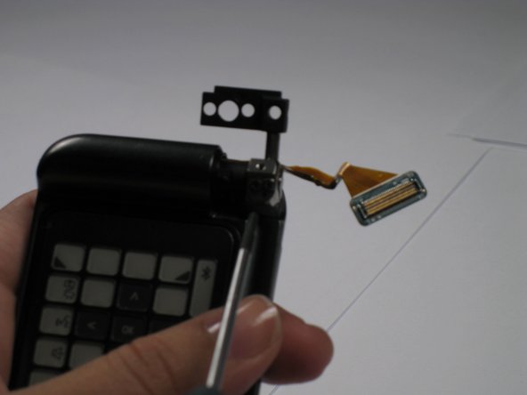

  12. Samsung Alias 2 Hinge Replacement: crwdns2935265:012crwdnd2935265:01crwdnd2935265:02crwdne2935265:0 Samsung Alias 2 Hinge Replacement: crwdns2935265:012crwdnd2935265:02crwdnd2935265:02crwdne2935265:0
    • Remove the two 2.71 mm screws on the hinge using screwdriver.
    • Under these screws will be a washer, spring, and small metal disc. Make sure you don't lose these.
