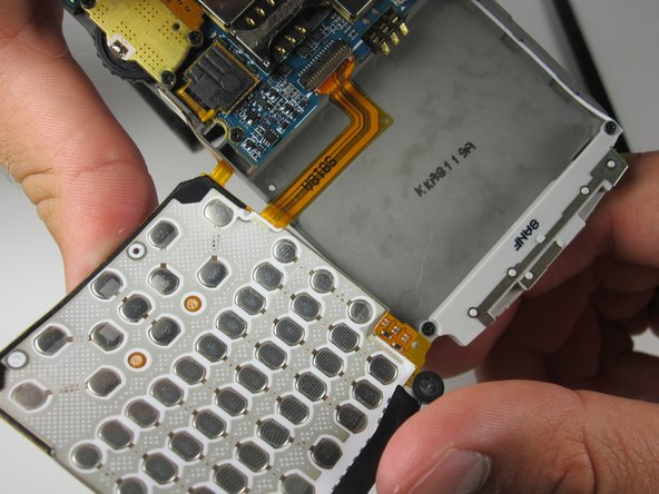

  12. Samsung Ace Keyboard Replacement, Keyboard: crwdns2935265:012crwdnd2935265:01crwdnd2935265:01crwdne2935265:0
    • Remove the keypad and place it to the side.

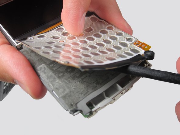

  13. Samsung Ace Keyboard Replacement: crwdns2935265:013crwdnd2935265:01crwdnd2935265:02crwdne2935265:0 Samsung Ace Keyboard Replacement: crwdns2935265:013crwdnd2935265:02crwdnd2935265:02crwdne2935265:0
    • Insert the flat edge of the spudger to the space under the keypad and slide it along the bottom to lift the keypad out of its place. The keypad should be stuck to the surface very tightly.
  14. Samsung Ace Keyboard Replacement: crwdns2935265:014crwdnd2935265:01crwdnd2935265:02crwdne2935265:0 Samsung Ace Keyboard Replacement: crwdns2935265:014crwdnd2935265:02crwdnd2935265:02crwdne2935265:0
    • The keypad will lift off the adhesive.
    • Be aware of the wires still connected on the right side of the phone.
