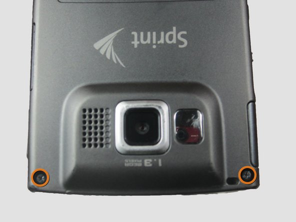

  4. Samsung Ace Back Speakers Replacement, Casing: crwdns2935265:04crwdnd2935265:01crwdnd2935265:01crwdne2935265:0
    • Using the Phillips #00 screwdriver, remove the four indicated screws (4.5 mm).
  5. Samsung Ace Back Speakers Replacement: crwdns2935265:05crwdnd2935265:01crwdnd2935265:02crwdne2935265:0 Samsung Ace Back Speakers Replacement: crwdns2935265:05crwdnd2935265:02crwdnd2935265:02crwdne2935265:0
    • Press the pointed edge of the spudger into the side of the two rubber plugs in order to lift and remove them from the top of the phone.
    • Then, using the Phillips #00 screwdriver, remove the two indicated Phillip screws (6.5 mm).

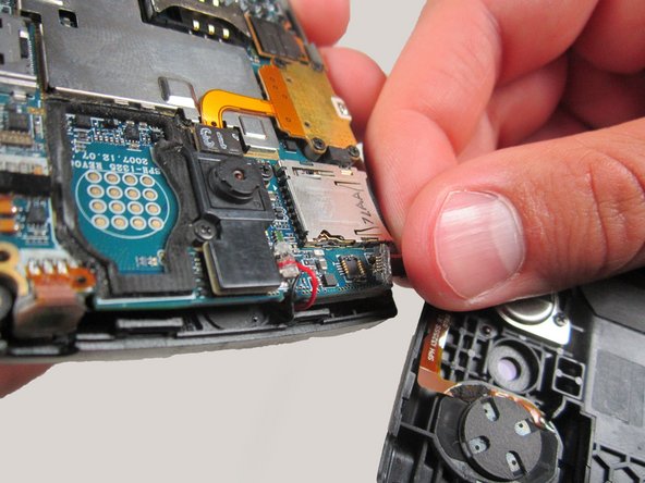

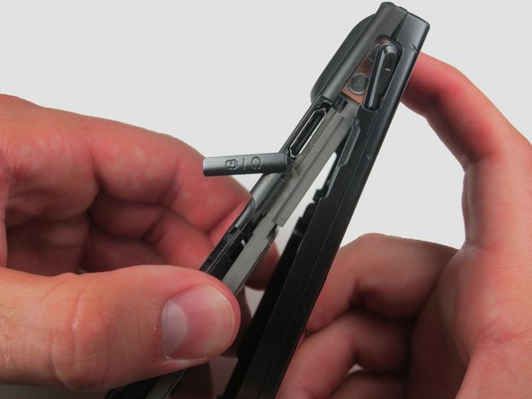

  7. Samsung Ace Back Speakers Replacement: crwdns2935265:07crwdnd2935265:01crwdnd2935265:02crwdne2935265:0 Samsung Ace Back Speakers Replacement: crwdns2935265:07crwdnd2935265:02crwdnd2935265:02crwdne2935265:0
    • Begin to slowly lift the back casing of the phone. You should hear a snap when the casing is released.
    • The power, volume, and camera buttons may fall out when separating the front and back casing.
  8. Samsung Ace Back Speakers Replacement: crwdns2935265:08crwdnd2935265:01crwdnd2935265:01crwdne2935265:0
    • Your casing should be separated and the three loose buttons put to the side.
    • Be aware of the wiring on the top of the phone. Make sure not to pull it apart when separating the case.

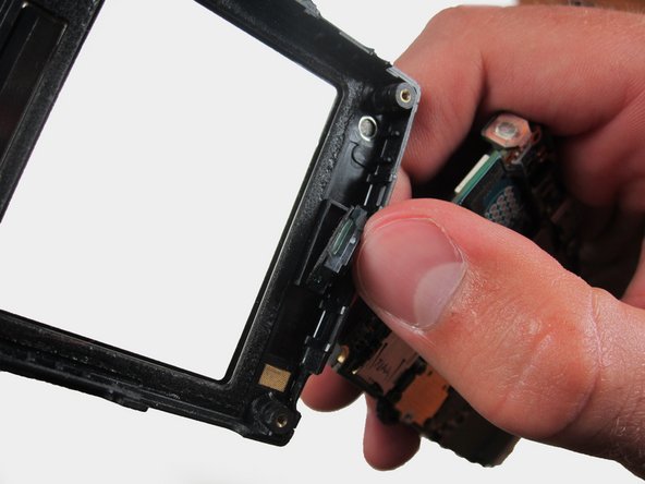

  9. Samsung Ace Back Speakers Replacement: crwdns2935265:09crwdnd2935265:01crwdnd2935265:02crwdne2935265:0 Samsung Ace Back Speakers Replacement: crwdns2935265:09crwdnd2935265:02crwdnd2935265:02crwdne2935265:0
    • Slowly remove the back casing by gently pulling the ribbon connection.
  10. Samsung Ace Back Speakers Replacement: crwdns2935265:010crwdnd2935265:01crwdnd2935265:02crwdne2935265:0 Samsung Ace Back Speakers Replacement: crwdns2935265:010crwdnd2935265:02crwdnd2935265:02crwdne2935265:0
    • Gently pull on the wires to remove the front casing.
  11. Samsung Ace Back Speakers Replacement: crwdns2935265:011crwdnd2935265:01crwdnd2935265:01crwdne2935265:0
    • Your front casing and front speaker are now released.
