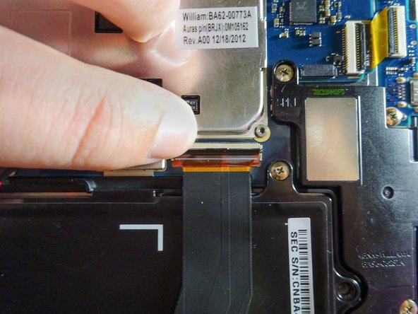

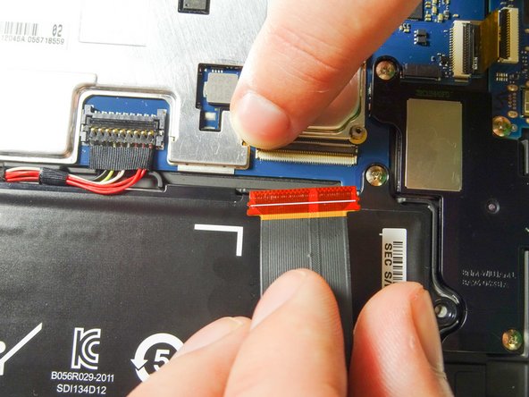

  3. Samsung ATIV Smart PC 500T Left Speaker Replacement, Battery: crwdns2935265:03crwdnd2935265:01crwdnd2935265:03crwdne2935265:0 Samsung ATIV Smart PC 500T Left Speaker Replacement, Battery: crwdns2935265:03crwdnd2935265:02crwdnd2935265:03crwdne2935265:0 Samsung ATIV Smart PC 500T Left Speaker Replacement, Battery: crwdns2935265:03crwdnd2935265:03crwdnd2935265:03crwdne2935265:0
    • Disconnect the three ribbon cables from the motherboard to free the battery.
    • Use your finger to lift the flap securing each ZIF connector.
    • Slide the ribbon cable out and towards you. Now it should be completely detached.
    • Repeat with the other two cables.
