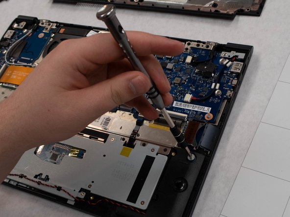

    • Using the Phillips #0, remove the seven 5mm screws highlighted in the image.

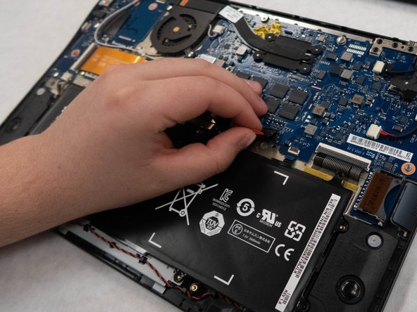

    • Using your hands, disconnect the battery's main cord from the main motherboard.

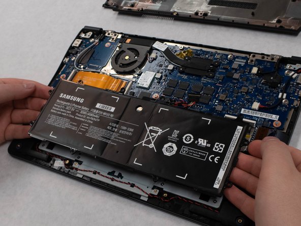

    • Using your hands, remove the battery from the computer.

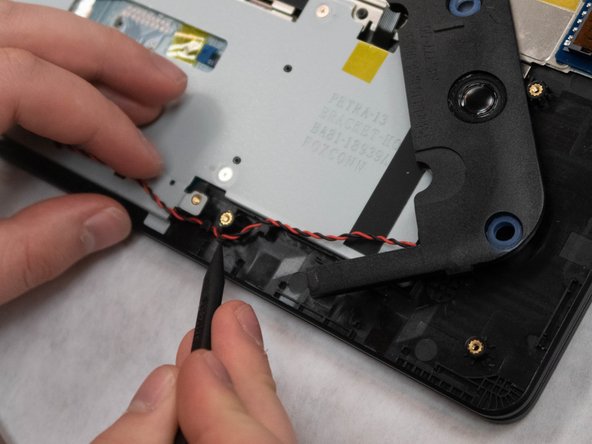

    • Using a Phillips #1, remove the two 3mm screws, one per speaker.
    • Using the nylon spudger, release the black and red wires that connect the two speakers.

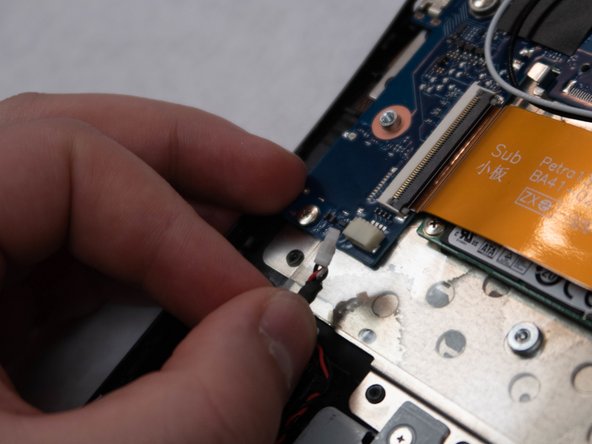

    • Using your hands, remove the cord that connects the speakers to the board you are removing.
    • Do not pull on the cord as that might damage it; remove it by pulling on the white wire head.

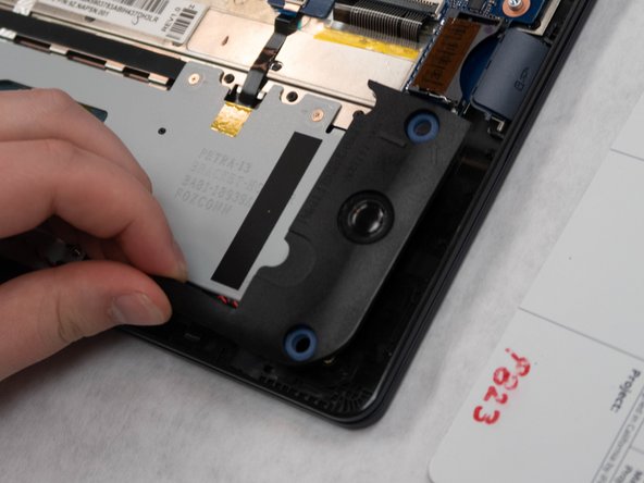

    • Using your hands remove the speakers from the computer. This may require some force as they are held in place partially by double sided tape.
