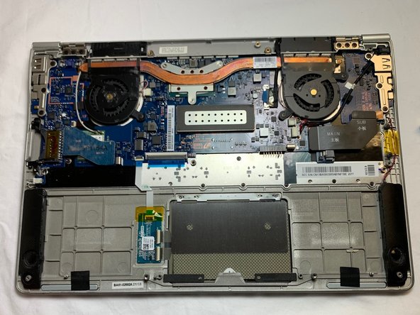

    • Make sure that the Samsung ATIV Book 9 is powered off and not connected to any power outlets.
    • Close the device and rest it on a flat surface.
    • Flip the device over to access the ten 4.3 mm screws located on the bottom case.
    • Remove all ten screws using the Phillips #00 screwdriver.
  2. Samsung ATIV Book 9 NP900X3K-S01US Battery Replacement: crwdns2935265:02crwdnd2935265:01crwdnd2935265:02crwdne2935265:0 Samsung ATIV Book 9 NP900X3K-S01US Battery Replacement: crwdns2935265:02crwdnd2935265:02crwdnd2935265:02crwdne2935265:0
    • Gently lift and remove the bottom case.
  3. Samsung ATIV Book 9 NP900X3K-S01US Battery Replacement, Battery: crwdns2935265:03crwdnd2935265:01crwdnd2935265:03crwdne2935265:0 Samsung ATIV Book 9 NP900X3K-S01US Battery Replacement, Battery: crwdns2935265:03crwdnd2935265:02crwdnd2935265:03crwdne2935265:0 Samsung ATIV Book 9 NP900X3K-S01US Battery Replacement, Battery: crwdns2935265:03crwdnd2935265:03crwdnd2935265:03crwdne2935265:0
    • Using a Phillips #00 screwdriver, remove the six 4.3 mm screws securing the battery to the device.
  4. Samsung ATIV Book 9 NP900X3K-S01US Battery Replacement: crwdns2935265:04crwdnd2935265:01crwdnd2935265:02crwdne2935265:0 Samsung ATIV Book 9 NP900X3K-S01US Battery Replacement: crwdns2935265:04crwdnd2935265:02crwdnd2935265:02crwdne2935265:0
    • Carefully lift the battery out.
