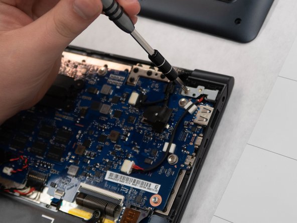

  3. Samsung ATIV Book 9 Lite Charging Port Replacement: crwdns2935265:03crwdnd2935265:01crwdnd2935265:03crwdne2935265:0 Samsung ATIV Book 9 Lite Charging Port Replacement: crwdns2935265:03crwdnd2935265:02crwdnd2935265:03crwdne2935265:0 Samsung ATIV Book 9 Lite Charging Port Replacement: crwdns2935265:03crwdnd2935265:03crwdnd2935265:03crwdne2935265:0
    • Using a Phillips #0, remove the one 3mm screw holding the metal holder/cover in place.
    • Using your hand, remove the metal holder that covers the port. This will take some jostling to remove.

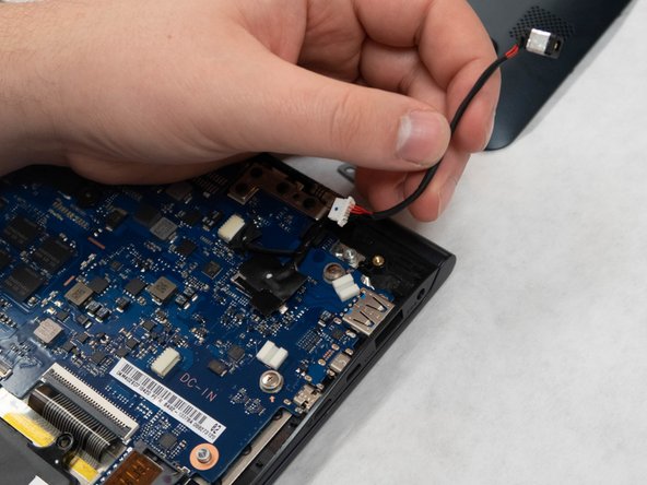

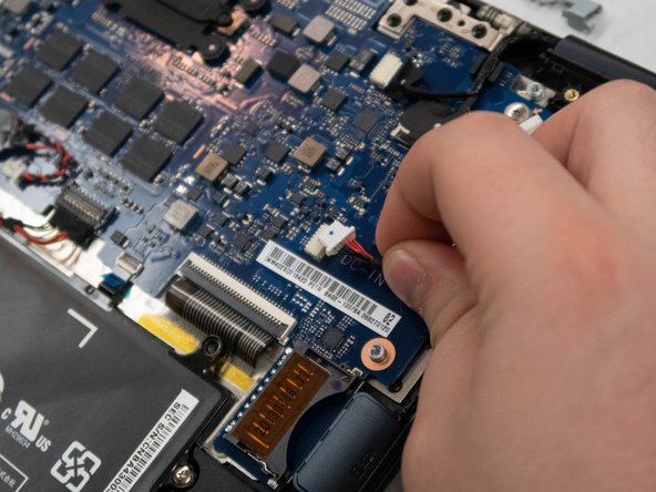

  4. Samsung ATIV Book 9 Lite Charging Port Replacement: crwdns2935265:04crwdnd2935265:01crwdnd2935265:03crwdne2935265:0 Samsung ATIV Book 9 Lite Charging Port Replacement: crwdns2935265:04crwdnd2935265:02crwdnd2935265:03crwdne2935265:0 Samsung ATIV Book 9 Lite Charging Port Replacement: crwdns2935265:04crwdnd2935265:03crwdnd2935265:03crwdne2935265:0
    • Using your hands, remove the cord that connects the charging port to the motherboard.
    • Do not pull on the cord as that might damage it; remove it by pulling on the white wire head.
    • Using your hands, remove the cord from the computer.
