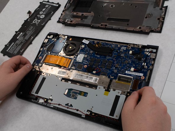

    • Put a protective lining such as a piece of cloth in between the screen and the keyboard when closed to protect your screen when performing this replacement.
    • Turn the laptop upside down to show the screws holding the back cover on.
    • Using a Phillips #0, remove the ten 4mm screws located around the edges and one central.
  2. Samsung ATIV Book 9 Lite Battery Replacement: crwdns2935265:02crwdnd2935265:01crwdnd2935265:03crwdne2935265:0 Samsung ATIV Book 9 Lite Battery Replacement: crwdns2935265:02crwdnd2935265:02crwdnd2935265:03crwdne2935265:0 Samsung ATIV Book 9 Lite Battery Replacement: crwdns2935265:02crwdnd2935265:03crwdnd2935265:03crwdne2935265:0
    • Use two plastic opening tools to separate the back cover from the laptop.
    • This may take some force because the back cover is snapped into place before the screws are used to keep it in place.
  3. Samsung ATIV Book 9 Lite Battery Replacement: crwdns2935265:03crwdnd2935265:01crwdnd2935265:03crwdne2935265:0 Samsung ATIV Book 9 Lite Battery Replacement: crwdns2935265:03crwdnd2935265:02crwdnd2935265:03crwdne2935265:0 Samsung ATIV Book 9 Lite Battery Replacement: crwdns2935265:03crwdnd2935265:03crwdnd2935265:03crwdne2935265:0
    • Using a Phillips #0, remove the seven 5mm screws highlighted in the image.
    • Using your hands, disconnect the battery's main cord from the main motherboard.
  4. Samsung ATIV Book 9 Lite Battery Replacement: crwdns2935265:04crwdnd2935265:01crwdnd2935265:02crwdne2935265:0 Samsung ATIV Book 9 Lite Battery Replacement: crwdns2935265:04crwdnd2935265:02crwdnd2935265:02crwdne2935265:0
    • Using your hands remove the battery from the computer.
